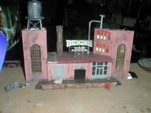

Hi Crew,
I'm resurrecting this thread 'cuz I finally got a new camera! YEAH!
Here are my smokestacks... better late than never.

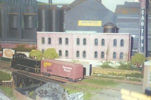

I made mine with some styrene covered with the brick -patterned construction paper they sell at MicroMark It has an adhesive backing, but I use a little contact cement and wrap a rubber band aroubnd it until the glue sets. I may model a roud smokestack using a piece of 1/2" or 3/4" PVC pipe. Tweet.
