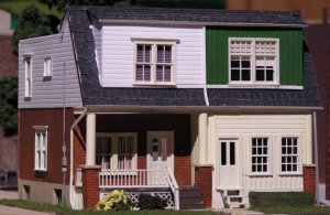

Anyway, here's a shot of a house I scratchbuilt showing the Rix gutters and a downspout made from strip styrene (as opposed to round). Rix does provide downspouts but they didn't have the profile I needed.
Val
