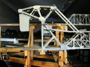

Hi there--I, too, am a refugee from the Atlas forum, which I found attached way too much importance to the number of posts and not enough to the content of those posts . I am also very glad to see that I can attach pictures without having to have a web-site, or mess around with Rail-Images. So----here is a picture of the operating drawbridge across the Nevawasa river on the Petaluma Valley RR. My layout actually goes around the walls and this is the entrance.
The drawbridge is built almost entirely of Plastruct. All bearings are steel pins in brass tubing. The hardest part in building was getting all the pivot points in the same plane, so it didn't bind. That, and I also had to figure out how one of these monsters functioned! This one works exactly as a real one. A small motor in the machinery house drives a shaft with pinion gears on each end, which run a rack on the operating arms. It's been functioning for approximately 8 years now, with very little maintenance. I think the main reason I built it, other than the fact it was a good solution for access, was that I had read in some Kalmbach book that no-one had ever built one that had worked for very long. I love a challenge!

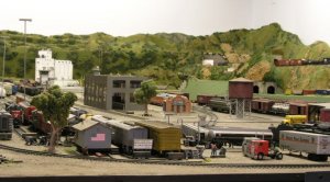

Also posting some more pictures of the Petaluma Valley RR.

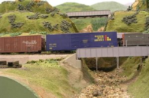

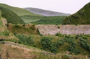

You have a great talent for scenary!!! I really like that third picture in particular for the way the hills blend into the backdrop. Excellent! Your lift bridge is an engineering marvel. Nicely done! Yep, you start posting pics like that around here you're gonna have to post more! :)
Ralph
I have to second Ralph on the backdrop. As the time is rapidly approching for that stage on my own layout I have been paying particular attention to that aspect on all of the pictures of other layouts. It's amazing how much range there is in the scenery, all the way from none at all to scenery that seems to go on forever and yours is definately among the later. Welcome to the Gauge and thanks for sharing your great pics. :thumb:
Unfortunately, I can't take credit for most of the scenery. It's been a collaboration between myself, Brad Lloyd, Dave Connery, and Denise Showalter. She is the artist who has done the background paintings. I did all the track, bridges, yard, etc (The easy stuff, not requiring any artistic talent), and Brad and Dave have done the rest. And are still in the process of doing it. One of these days, I'll show you the rest of it.
Angus Macdonald

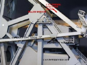

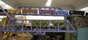

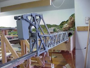

You know--I wish I did have drawings or specs, but I started with a 1/2 N-scale drawing of a drawbridge, scaled it up to HO, and just started building it. I checked girder sizes in the Plastruct catalog and ordered what I thought I needed. I think by the third re-order, I finally had everything. It's probably not exactly to scale, and it wouldn't please a rivet-counter (it doesn't have any!), but it's hell for stout. Plastruct now sells styrene materials that are more to scale with more prototypical dimensions, and I would use these, were I to do it again. I do plan on building a vertical lift bridge for the third bridge across this space, but that's off in the future.
I've attached a couple of pictures to help explain some of the features.
