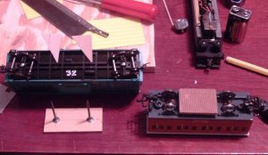

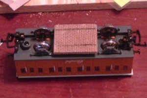

Keeping the track clean goes a long way, too. Mount a Masonite pad like so under one of your cars and run it with the rest of the train. The mild abrasive action keeps the rails quite clean allowing no major gunk build-up. The nails ride freely in holes drilled into the bottoms of the cars. If you pick up the car, the cleaner simply stays on the track, there are no fasteners. I've shown it installed in an Athearn Blue Box Hi-cube and a coach from my Thomas the Tank engine consist. The pics pretty much tell it all, if you need pads just PM me, I have several.

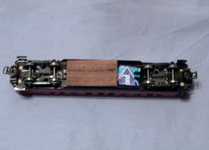

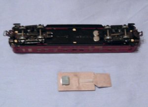

My tinplate gave me pause. No way could I drill thru the floors on these. I came up with a magnetic pad for the cars that work great. Using a small flexible piece of plastic I sandwich glued it onto the pad. I sandwiched small magnets into a pad on the other end that catch still more magnets on the bottom of the car. Once "stuck" in place, it does a beautiful job of cleaning the track.

Thanks, once worn, just buff them out with some light sandpaper, it'll be years before you need to change them out.
