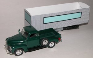

Eyeballing a suitable-looking rig gives me a body width of 1-7/8 by 6" long by 1-5/8" high to the roof line. Here is a picture of a paper sample I made for test fitting to an Athearn SW1500 diesel chassis.
My "Tipsy-Turkey" will be loosely based on the fantastic "Waddling Duck" Shamus shared with us. The Turkey will be different with the corrugated siding applied vertically and a different truck.

As for the Turkey body I would suggest going 2"x 6 " x 2" or in 0 scale 8' x 24' x 8'.

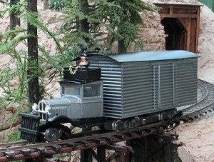

The "Waddlin' Duck" that Shamus did looks about what I would think a backwoods railroad would throw together. I like to make stuff that looks like it had to be designed a certain way for simplicity and practicability. Since I've already put in a lot of time staring at pictures Shamus posted, this style will be my first try.
The "Wobblin' Woodie" by Shaygetz is another interesting direction with a complete vehicle towing a trailer..another concept worth pursuing. I have lots of time.
Here is a picture of the Shamus "Waddlin' Duck" I borrowed from another thread here just in case someone may have missed it. To me, this is a gem and a classic of On30 utility vehicles.
Shamus really nailed the type of vehicle that a stretched-budget small outfit would have cobbled together from whatever was laying about.
