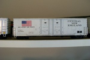

First: the flag and "We Support Our Troops"

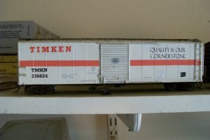

Second: Timken, the moto, the reporting marks and even the stripe.

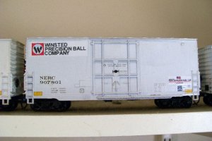

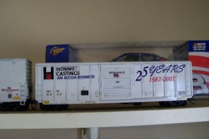

Third: Company name, and 25 years, with the years.
Fourth. This one was using Testors white paper. You can see the difference in the white of the paper, and the white I painted the car. Thsi only happened because I ran out of clear.
