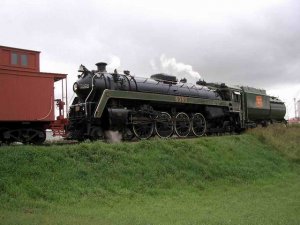

Number 6060 does excusion runs on the Stettler to Big Valley line during the summer. Did the ride myself a couple of years ago.
Heres a photo of 6060 ready to leave Stettler which is about a 2 hour drive south of Edmonton.
Dennis
