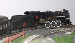

OK, here are a couple pics. I have a few others as well. It's not perfect but feedback is welcome! (The pics seem to magnify the imperfections!) Thanks, Rob

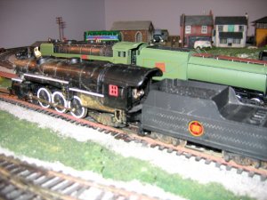

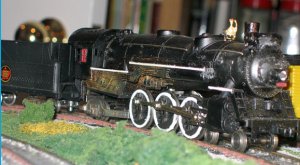

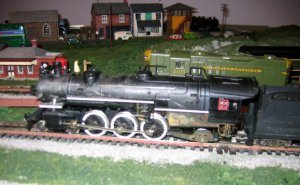

Here are a couple more pix.
Again, these pics catch the gist of how it looks but they seem to exaggerate the imperfections! :cry: It looks much better running on the layout from a distance of a few feet. :mrgreen:
I'm open to criticism!
The one pic shows my GP-9 in the background -- this was another kit-bashed project. It used to by a UP GP-18.
Thanks,
Rob
Good start, Rob, although I think you may regret not adding the piping when you did the work - to add it later will require that you remove the components to drill them to accept the wire, putting you right back to where you started from. :eek: The photos also emphasize the different shades of black, particularly on the tender. Usually, the cab and tender are similar in colour, even if the rest of the loco is a different shade of that colour.
It also looks like your loco's whitewalls are too wide: normal practice was to paint only the side of the tire white, while the wheel - spokes, counterweight, and rim, remained black.
I give you full marks for attempting this conversion, though, as it's always a bit unnerving to alter any loco for the first time. :thumb:
Wayne
Thanks for your feedback, Wayne! I sure appreciate this.
I've responded below, to your comments:
-- I was hoping it would be fairly easy to drill a few small holes for the wire, even if I did this later. I probably won't add ALL of the piping as well, just enough to make it a little more realistic.
-- the loco and tender were originally the same colour, so somehow my weathering was inconsistent!:eek: Actually, last night, I added more light grey weathering to both the loco and its tender, so I think I've made it more similar.
-- yeah, I guess they are too wide. It was a challenge to paint this and do it smoothly/evenly.
-- Thanks again, Wayne. As I said earlier, the loco looks MUCH better running on the layout from a distance. These pics really seem to exaggerate the imperfections. I noticed this before when I did a previous kit-bashing project, when I converted one of my small British tank locos. It looked great on the track but, when I photographed it and placed pix on The-Gauge, blobs of glue and rough edges stood out like sore thumbs!
Cheers, Rob
The photos emphasize the different shades of black, particularly on the tender. Usually, the cab and tender are similar in colour, even if the rest of the loco is a different shade of that colour.
OK, I now realize what the difference-in-black issue is. I had used some gloss paint to paint out the previous numbers and decals. I used this on the sides of the cab as well as the sides of the tender. After I spray-painted the tender with some clear flat paint, the gloss effect disappeared entirely and the tender looked nicely weathered & used. I haven't yet spay-painted the cab sides yet — I'm hoping, once I do this, that this will nicely "weather up" in a similar fashion.
I also haven't chosen a number for this loco. Since it's such a fudged project, I'm not sure which one to chose!
Thanks again -- your comments & feedback are helpful.
Cheers, Rob
