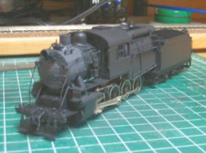

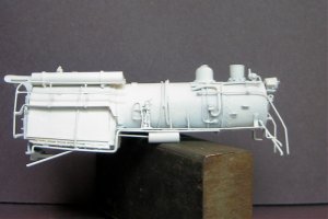

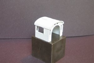

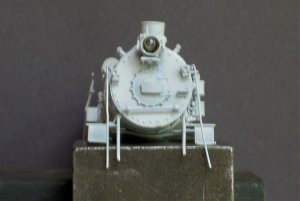

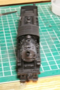

:thumb:I just primed my CNJ 4-8-0 THAT I have bin working off and on with over the last few years. Now she is ready for paint:rolleyes:. When my rivets (for the valve gear) and decals come in I'll finish up.

That's going to be a neat looking loco (once you put a lens in the headlight! :p )... is it brass, or did you kitbash it?
:mrgreen:No,no,no,:mrgreen: That bulb is just a temp. The boiler is brass that I rolled myself .The cab is a slightly modified cab from a New One 4-6-0 Camel back from the 60's (I think). The tender is a Bethlehem car works kit (not shown). the pilot is scratch built from brass ,along with most other detail parts. The drive is a heavily reworked Mantua frame with a Sigami can motor W/custom turned fly wheel. NWSL gears and Mantua drivers. The valve gear is scratch built (almost complete). Cylinders are modified Bowser. And last but not least the fire box is scratch built from brass and plastic with help from Bethlehem car works parts. I have other pics posted somewhere on this site.
Great looking work, e-paw, and much more ambitious than anything that I've done. I hope that you've got both a right-handed and a left-handed fireman lined up for that loco, though. ;):-D I look forward to seeing some photos of the completed loco.
Wayne
At one time 2 fireman were used. Somewhere around 1930 duplex stokers were installed. That small box on the foot plate under and between the fire box doors is it's cover.

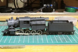

The Paints Still Wet

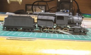

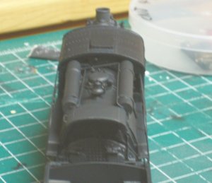

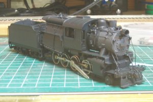

the new air brush came in the mail yesterday:thumb: so I had to give it a try. Now if only my decals and valve gear rivets would come in:confused: I could get some more dun on the old 4-8-0.

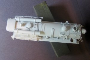

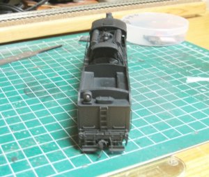

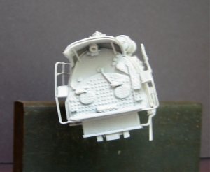

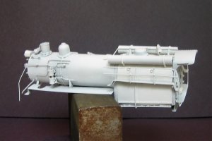

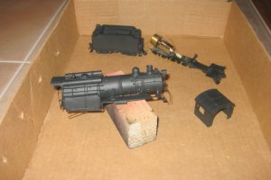

got some more done.
take a look.
