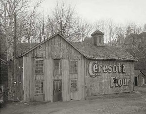

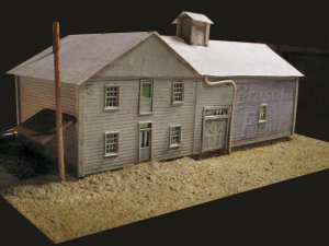

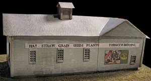

:wave: Hi all again, I found this pic on the web and for some reason fell in love with it. It's simple features, the signs, the whole darn thing. So I thought I would try and catch the essence of it in N-Scale, I am not done with it yet, but what do you think so far.
The first pic is of the real thing and the second is my model I scratch built. DUH :oops:

Which one is the model, the top or the bottom picture :)
Immediately when I saw the picture, and before I read our post, I thought "wow, what a perfect building to scratch build", and you did a fantastic job at that.
I too would like to know how you did the sign on the wall.
Great great building. :thumb:
:wave: Thanks everyone for the kind words. To put it simply, I used v-groove styrene for the basic building (only four walls), a lesser width boarding for the peaks, and card stock with printed shingles for the roof (although the light faded in the picture on the right side) I did on the puter. The sign I made using typing paper as it is much thiner than regular paper. The color will vary on typing paper for the same reason that it is thin, so allow for this, mine turned out a little darker than I wanted but oh well. I used a grey primer with alcohol and india ink wash to wheather. I think the windows and doors are Grant line. The end walls and the back wall were done my way as the picture does not show in the prototype. There are only windows on the back wall, a loading area on the far end area and a door and window with a roof on the other end. More signs are on the back wall. It is a simple building but the looks just drew me to it. I have pictures of all four sides if any one would like to see them. I also made plans for it if anyone would like I can e-mail it to you. (has actual ft. dementions on it for any scale) I was going to make a tutorial of it, but don't have the patients for it once I start. Hehe.
Thanks again, Jim :D

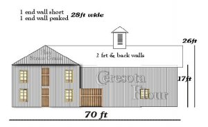

:sleeping: And here are the plans I did on the computer and worked off of. The peaked end I used for the dock is the same size as the frt. & back peaked. Makes it easier to do. Hope this helps and enjoy. I am off to do something else. :eek: ;)

You have taste Jim
Man oh man Jim, that's a real gem. :thumb: :thumb: :thumb:
Everything about it radiates the charm of a slower pace of life that we seem to have lost.
I hope you don't mind sir, but I filed it all for my future reference and danke, danke, danke for the drawing too :wave: :D :D

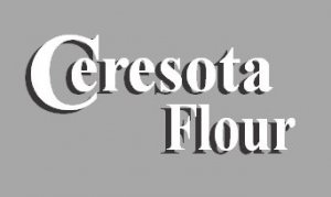

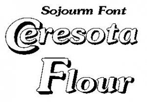

another question about the sign.
Which program and which font did you use to create the Cereta Flour sign?
I tried to make one in PagePlus 9 using 'Times New Roman' font, but it doesn't look right, yours is much closer to the real thing
Again great work, and thanks for sharing.
See this is what I got, not even close.
Jesper, here is the font I used with a little work on it. :wave:
