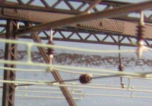

Oh, here is a close up

I need to ask where you got the insulators, since they are a detail i need. did they come with a model memories' kit?

Hi Chris, yes, insulators come with Model Memories kits and are also sold seperately.
