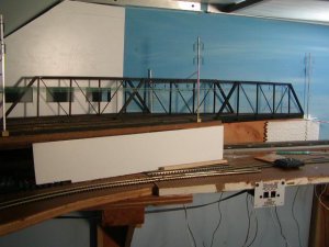

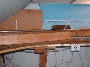

Hi Chris, I only have about 4' on the front track, less than 3 on the rear track. I will have a stationary train posed but won't be able to have it actually run. I cobbled up a pair of bridge girders (?) from styrene strip. Just to see how the idea of a bridge there would look. I'm inclined to pursue it a bit further. When I checked I found Central Valley only makes this bridge single track. I will scatchbuild two double track ones, if that's the way I decide to go. The photo shows how skewed the bridge ends will be due to the angle over the Tracks below. The styrene strip sitting upright against the future brick wall shows where the rearmost bridge member will be. If I go this route I'll only be able to use one of the Model Memory bridges, and I need to figure out the mechanics of running the catenary thru the bridges, I can't make it out in the photo Chris provided, tho it looks like there is a double track wide catenary bridge immediately in front of the truss bridge.
Even without the vertical columns installed in the bridge I can see it will be fairly effective at solving my meeting the backdrop problem. Like so many others tho I have a hard time with change, and I kinda miss the look I was going for in that CNJ photo. So I'm torn but proceeding to see how it grows on me.

Actually, I bought the premade ones, and one kit, as yet unbuilt. I've done a bit more with the bridge and done some measuring, I would love it if you are able to get me some info on catenary on bridges. Failing that, I found that I have 19" from where I will install the four track Model Memories catenary bridge and the front edge of the truss bridge. A few measurements so you all can get a better feel than the photo supplies, the bridge is 17" long, but skewed 10", so total length is 27". That's a heck of a skew! Anyway, I think I can install a double track catenary bridge with its front pole just in front of the bridge, and with its rear pole within the bridge. That's just my latest thought, anyone who knows better please advise! The 19' spacing is perfect for the Model Memories catenary wire.

ok here is what i found out. catenary in truss bridges are simple. on each beam that goes the width of the bridge on top has a little insulator hanging down, which holds the catenary wire.
Thanks for the info on the catenary on bridges Chris. I've purchased Central Valley's bridge girder set and am starting construction.

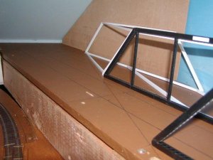

Back again with another question. It is a bridge question, not catenary, but thought since I'd started here I ought to continue here. Can't hurt to bump the thread too! I've assembled some CV girders and built up the sides of one bridge. The mock up I built first is behind the new sides in the photos. You can see I have quite a skew and was hoping someone can tell me how a real bridge would construct the deck carrying the ties and rail. Would there be two single track decks or one double track deck? Thanks for any info.

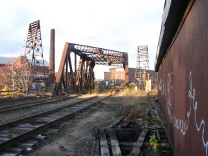

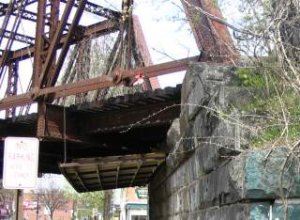

This is a different bridge, but gives you an idea of how the tracks were supported. This is a double tracked bridge.
If you don't have a copy of Model RRer's Bridges and Trestles , get it. I highly recommend it.

Those are great shots zedob, I think that answers Gary`s ?

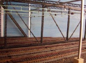

I'm back. I was away from modeling for several months. In the last week I attempted to solder the caternary wire to the bridges. Wow! I have new earned respect for all you who build working caternary. Luckily for me, there won't be any operation under mine. I gave up solder and used super glue. The attached shot looked better before I had to reduce it to meet the max allowed here. I'm going to have to paint a bit of right of way on the backdrop, but not too much. I had read that the wires should be painted the green of oxidinf copper. At this point, prior to weathering, it is too stark. My thought is to apply weathered black from above, to appear as grime. Any suggestions?

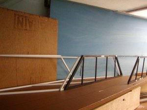

A view from a bit of a distance to show the corner I'm working in. The white styrene wall with window cutouts is my current project. Brick to be applied soon, windows are built and ready. What will make this a bit of an experiment will be the neaon sign I hope to put above the windows. I'm also busy casting cut stone wall sections, as seen in the photo. The white foamcore in front of the corridor will be those castings. A building will be to the left of where the foamcore ends, hiding the tracks hitting the corner. What do you think?
