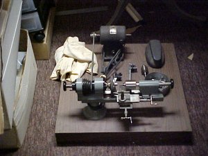

Bill S. and Jon, Here's a pic of the little lathe. I can't identify who made it. The is a logo engraved on it but I can't read it. I did find one mark that said Made In Switzerland. It's calibrated in metric increments and is beautifully made.

kewl! I would go by the local plastics supplier and see if they have some scrap bar stock you can get cheap or free and just have at it. The biggest thing is to move the tool slowly into the work and just a little, then you can move across to remove material and reduce diameter. Just play with it and you will get the hang of it. If you move the tool intot he work X thousanths, you will remove 2X. Plastics and brass are easy to machine. Plastic is actually a little harder to get accurate. If you move the tool in .002, it will remove a little less than .004, as plastic likes to get out of the way of the tool. A lot of the time you can just use a file to shape the material as it spins. You will have fun with it. I'll be sendign drawings for all the little parts I need. How 'bout a nice brass bell? :D :D :D

I've finally been able to identify the mfg. of the lathe. It was made by the F. W Derbyshire Co. of Waltham, Mass and not in Switzerland as I orginally posted. The Jacobs type chuck has Switzerland stamped in it and that's where I got that idea.
The company is still in business although they only mfg. CNC machines now. It was orginally cataloged as an "instrument lathe"
I've hooked up with a gentleman in England who is a collector of old lathes. He had some pictures on his website of some Derbyshires that were similar but not exactly the same. The basic design goes back to 1911 but its obvious that this one is much more recent. Hopefully he will be able to give me some more on its history. The company's website gives no information other than a telephone # and address and instructions to contact them thru dealers so I sorta got the impression that they may not be too "hobbyist friendly":D

Hey Vic, I did talk to my machinist about the lathe and he said just learn by using it. He said you'll learn it's capacity when you try to take off too much. Pretty obvious to keep you fingers back from the tool while it's cutting (that wicked machine could easily take off a fingernail, well at least the tip! :D :D :D ), but also watch loose clothing, long hair and jewelry, if you are so inclined :rolleyes:
I don't know if I said it before, one of the easiest ways to work with a lathe, and especially if you want a radius, is just use a file while it's spinning. You should probably put a wooden handle on the file; P-K can't afford another machinist law suit and Paulsen's getting tires of pulling that file tang outa workers palms! You would get a cool Jesus scar though :D

Jon, Thanks for the information. Sure don't want to loose no fingers!:D Have found out that that projector spring that's on it for a drive belt is something that someone rigged up and is gonna cause problems with the pulley on the drive spindle. It can't be readily disassembled to put on a continious belt so what I'm gonna have to do is get some of that 1/4" belting that you cut to length and run it thru the pulley and then heat the ends to join them together.

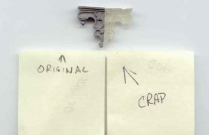

Bill: I have poured a whole lots of hydrocal and this resin stuff is a whole new ball game. The picture shows one of my miserable attempts with a two- part auto epoxy just to practice with. I have a friend that models O-scale and he has kind of talked me into doing 50 of the shown brackets and 12 of some even smaller ones for some sort of architectural overhang. The two- part epoxy I'm practicing with is like Karo Syrup so gooey it could never flow into the minute crevices. Can this Micro-Mark two- part resin be measured using two syringes.. to conserve the product. I only have two cavity molds. At 10 minutes per demold I''ll be real old before the process is finished.

The Micro-Mark resin is fairly thin --- probably not much more viscous than water. I see no reason why you couldn't use syringes to measure it. (And measuring is a snap as it is 1:1.) In the molding I've done so far, I mix in the little paper "bathroom" cups, and have always just made rough guesses on proportions. As I've not had a bad batch yet, I'd guess that the mix isn't too super critical. By the way, the resin bottles are plastic, with dispenser caps, so are easy to use.
If you have the original pattern, why not make six or eight RTV molds. You'd get more parts per pour, and wouldn't be too aged when you're finished.
By the way, the resin is clear when it's liquid (which is nice for looking down into it to see if it covered everything, and cures to an opaque white (nice for inspecting the parts.)
On a fairly complex part like your brackets, you might want to vibrate the mold after it's poured or snap it a few times with your finger to shake any bubbles loose so they'll rise to the top.
