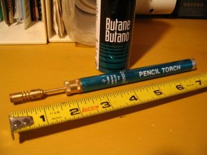

I tell ya, this is a small torch.
TrainClown ;)
