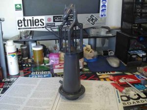

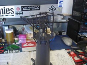

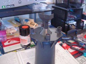

Step 1
Here I have assembled the Furnace halfs, the Bust Pipe, the Mantle ring to the Bust Pipe, the Bell Hopper, and the Sheaves to the Sheave Rod.

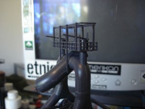

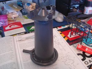

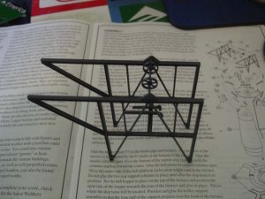

Step 2
Here I have assembled the Bell Beams and the Trolley Support. I then put the Bell Beam in place on the Trolley Supports and also glued the Sheaves and Sheave Rod in place on the top of the Trolley Supports.

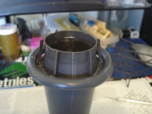

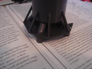

Step 5
I put the pipes together but only glued in a couple spots (it says to leave the others unglued for now for later assemble. this was just a pre-assemble on how it goes together) and placed the Trolley Supports in postion, again, not glued in place yet.

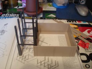

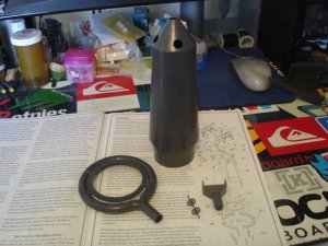

Step 9
I glued the Trolley Supports to the Bell Platform. I noticed that the Beam Bells were in the wrong spot because the Trolley Supports would not fit because of the location of the Bell Hopper. I moved the Beam Bells to the right loccation which is right next to the Sheaves and Sheave rod.

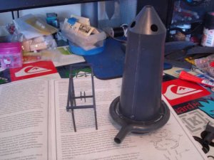

Step 10
I then put the top of the furnace together. I glued the Bleeder Platform to the tops of the Offtakes. Then the Bleeder Valves and Bleeder Handles were added on top of the Bleeder Platform. Next, the handrails were added around the Platform and was finished off by glueing the Platform Bracing to the top.

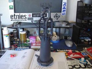

Step 11
Next was to glue the Offtakes to the Lower Offtakes on the Furnace. Now the Furnace is almost complete. All that needs to be done is adding the handrails around the Bell Platform and painting. The handrails will be added after they have been painted yellow. The furnace also gets a nice coat of rust brown primer. That's the next step.

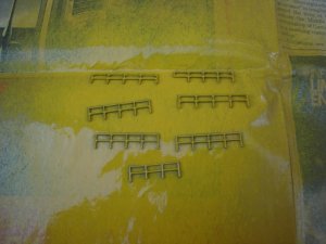

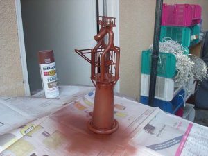

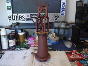

Step 12
I sprayed the Furnace with rust brown primer and the handrails have been sprayed yellow. The paint is still wet and the flash on the camera was used for the furnace so that is why they look so shinny.

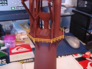

Step 13
Here is the finished Furnace with yellow handrails. You can see that the color is more of a rust brown and that the railings are a real eye catcher, just what I was going for.

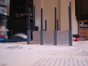

Step 14
I started to assemble the Hoist House and Main Furnace Building. I sprayed the brick encasements on the columns grey, they were origionally a yellow brick and looked really bad.sign1
