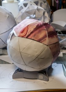

Do you want the tutorial on the shape of the triangles or on placing markers in Google earth to getting the image onto the triangles? With making the triangles it's mostly trial and error with the Coreldraw polygon tool. The globe structure is the hard part. It gives a regular grid for attaching the triangles. But not that I've don't it I think I can do how to get the grid onto an existing globe without building the entire structure.
Both! The whole process. I'll put it into .pdf form and will place it in the tutorial section in our Resource section.
This really is Non Euclidean Math, and is hard to do in CAD. If I had a starting point, I could probably figure it out, problem is spheres don't flatten out, so I would have to find something faceted to use with a globe in mind. I think I just figured out how to do it!
