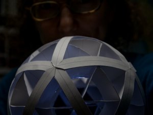

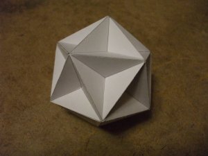

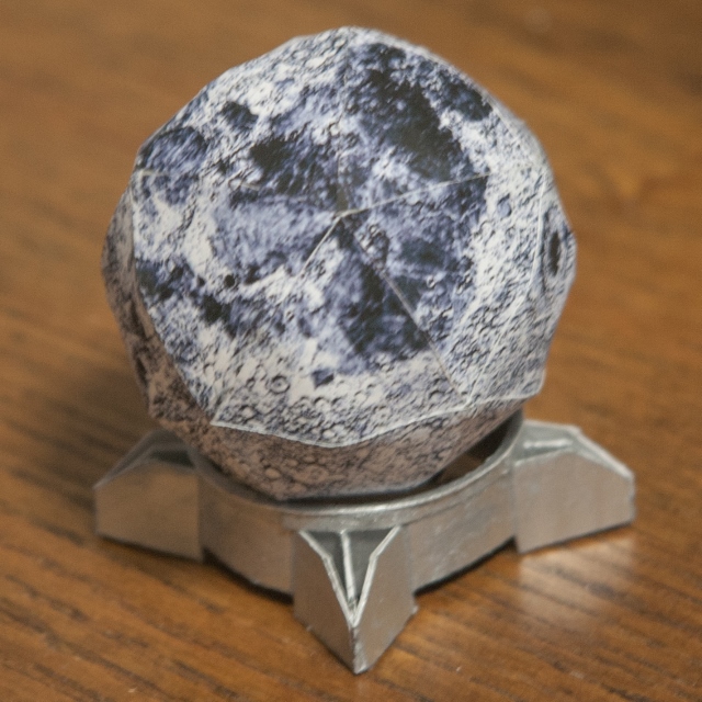

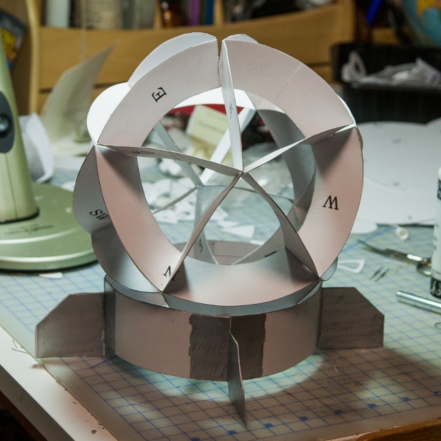

I used to make paper models of the 5 regular solids for extra credit in math class. I ran across a book way back in fifth grade that had a patterns on variations of polyhedrons and FINALLY located a copy through our library loan program (Mathematical Models, 2nd Edition, by H. M. Cundy and A.P. Rollett). There was a model that had become my favorite and I was able to draw up the flat pattern that was in the book. It was difficult to put together so I rearranged it to be MUCH easier to assemble. Here it is:
Best Regards,

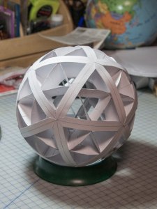

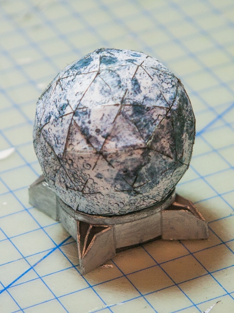

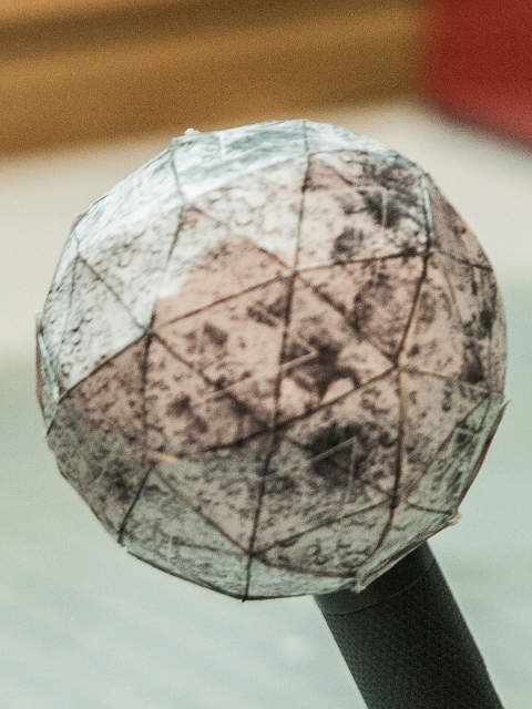

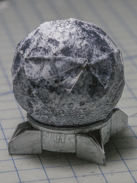

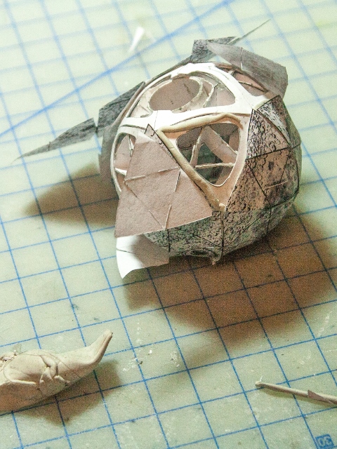

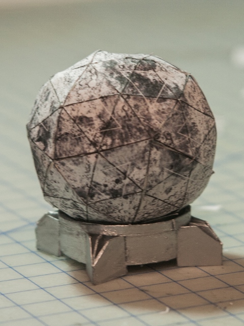

I was traveling over Christmas and failed to sync my files to the cloud so work came to a standstill. I'm back. Here's the moon model with the stringers.
20160108_6184 (480x640).jpg I put the map on using poster putty. This lets me move things around and I can remove the map if I want. The surface image is an icosahedral map of the moon designed by Calvin J Hamilton. He has other moons and planets as well. They're set up to use as models without any support structure.
http://planetscapes.com/maps/ico.html
I used Photoshop to adjust contrast. Then I imported it into Coreldraw and placed my grid over the top.

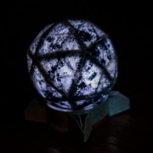

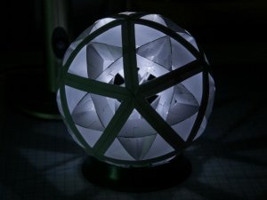

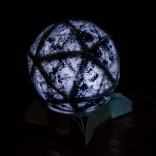

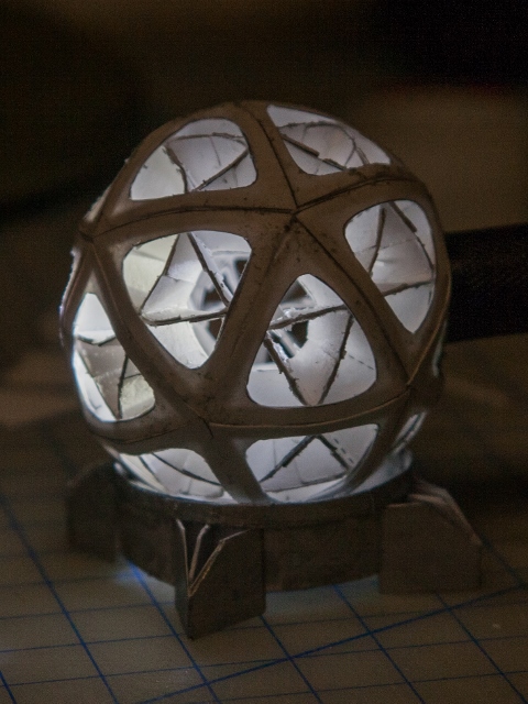

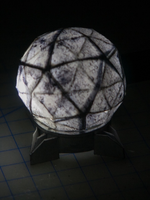

20160108_6185 (640x480).jpg Here's the model with the light behind the map.
20160108_6190 (480x640).jpg And without the light.20160108_6193 (480x640).jpg I think the gird pattern may be too dominant. the next time I'm doing the grid in white.

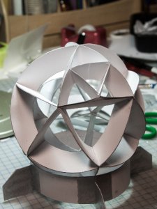

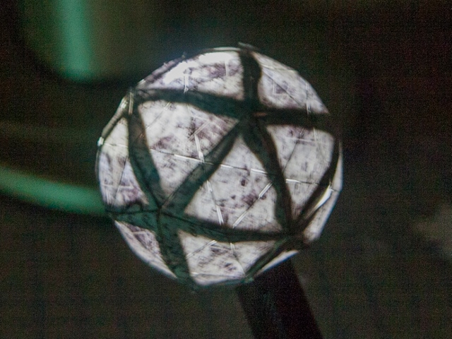

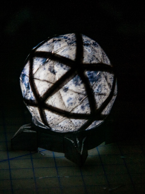

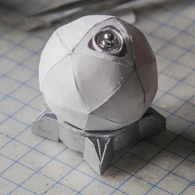

20160109_6205 (480x640).jpgI've got it down so I can build one of these in under a day. I'm still working on it. I've arranged the parts on the page so that they can be scored faster. With this one, I left out a set a stringers and also modified the jpg map so it's blue. I'm going to try it completely without stingers. They make the dark bars when it's lit up. I'm also thinking of painting the map features in acrylic so that the craters are more opaque.

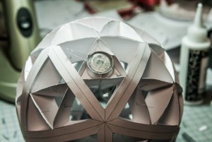

20160118_215359 (480x640).jpg 20160118_215552 (480x640).jpg I found a use for the model. I coach kids cross-country skiing in the evening. In Anchorage, we have lighted ski trails. It helps kids find their coach if the coach wears a distinctive hat with lights. My hat is a sort of Jesters hat with three points. The balloon lights which I ordered came today. They have a smaller diameter than the flashlight I've been using, but I made one fit with some paper, glue, and poster putty. Add a split ring and a safety pin and it's a distinctive addition to my coaching hat. I might put a moon or planet on each point of the hat.

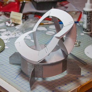

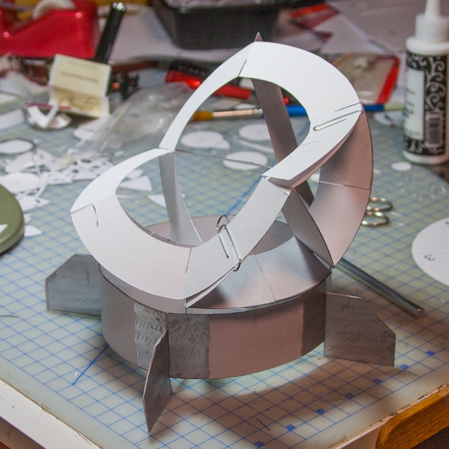

Onward with scaling up. It goes slower than a 2" model since each part goes as a separate page to be printed, scored, and cut separately. I've been looking at the Glowforge for cutting, but I'd prefer using someone else's machine instead of putting out the money to buy one.

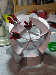

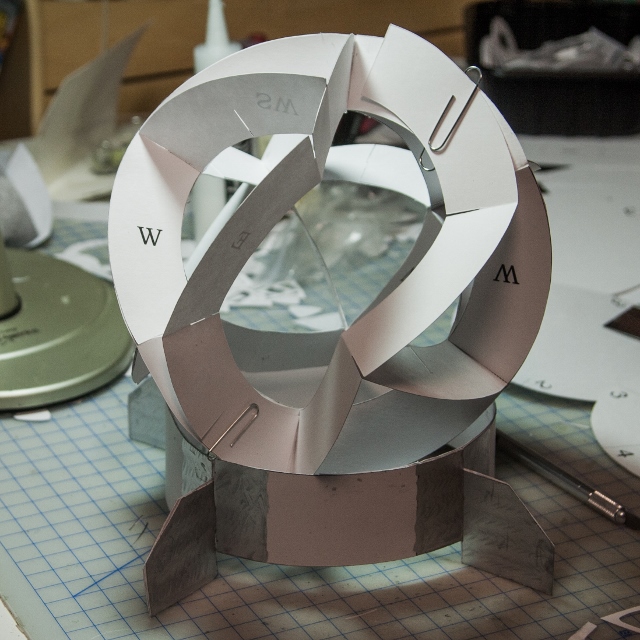

I've been putting in one or two parts per day instead of doing all 20 of the parts in at once. Oddly the interior triangle of the subdivision ends up with sides which don't quite reach. I'm not sure why. Every strut section should be the same size.

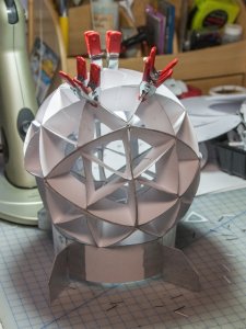

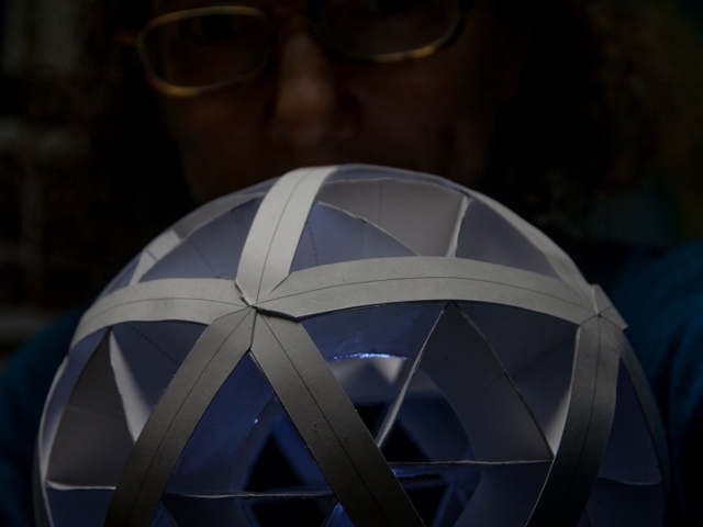

Clamps seem to be needed in this scale.
Almost done with the structure.
