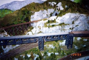

Hello folks; ...a "back Northeast corner" of home H0 layout is shown...first section of rewoked layout.
Rear unit is a wood pile trestle, curved, shortline construction.
Front unit is part of combined deck and girder bridge.
One standard 9"Atlas deck truss, one 14" long deck truss, kitbashed from two standard Atlas units. There are also two spans of Model Power girders, to the right. The "steel" towers are 'scratch-bashed' from Model Power water tower sections, pieces of Kibri and Faller bridge trusses, pieces of miscellaneous styrene and Plastruct, and even a couple of chunks of an old Triang OO automobile car !

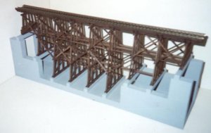

Sorry..apparently the pictures of the layout are "KB-excessive". Will see what I can do. Meanwhile, I do have a few custom trestle shots of recent units built for next train show:
HO semi-scale 130' high, 45' high trestle, all maple bents, girts, wall braces. All stripwood ripped in-house.
Pine & maple deck, Atlas code 100 flextrack
234 pieces, 734 glue joints.

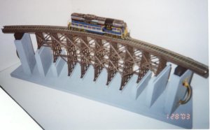

Last shot is a 24" long curved trestle, 24" radius, all pine construction as before. Deck is spline type roadbed, made with pine strip and birch spacer blocks.
280 pieces, 750 glue joints, Atlas code 100 track installed.
The locomotive is one of those old "widebody Athearn GP-7's"...that body is my original locomotive shell from 1957...but it has a 1966 Athearn gear drive in it !

OK trying again, photo is "downsized" or however less KB should be said:

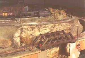

Here's a scratchbuilt wooden truss on my N scale pike which was dismantled 30 years ago.

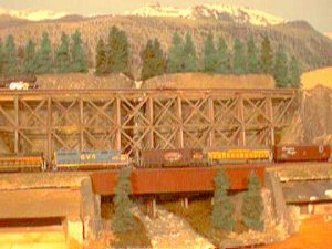

Here are a couple of scratchbuilt efforts crossing the Badger Creek.
Shamus suggested I name this creek in memory of his old layout.
The trestle is made out of pine strips I cut with my bandsaw. It is held together with white glue.
The double track girder bridge is made out of cardboard. My favourite buildng material.
Some day I will get a better camera!
Robin,
I'd say your creek deserves the name.:cool: :cool: That's quite a selection of power there, I see "the yellow borg"(UP), and Catt's GVR, but I can't make out the other two, or the steam on the upper level, What are they?
Pete
Pete, I really must get a better camera so you can see the details. It is embarresing to post such poor quality photos.
The lead loco eastbound is a GP40-2 in MAT colours, number 2105. The loco I interchange with Catt's GVR number 4933 is also a GP40-2. The trailing loco is another GP40-2 in BNSF colours, number 2177. The westbound UP loco is an SD-60M, it is number 2380.
The steam loco on the trestle is a Bachmann 0-6-0 USRA switcher pressed into logging service.
I don't have and shay or climax type locos for the logging section.
Nothing available in N like there is in HO unfortunately. Will have to try scratchbuilding one or two.
I have tried to get a better close up using my old SLR camera with a 100mm lens so had to set up the tripod ten feet back. You can see the bridges better and the girder plate deck bridge shows some detail. All it is made of is strips of corrugated cardboard 1 1/4 inch by 10 inches. I then glued strips of cereal box cardboard to give the dimensions of the plates. 3/16th inch strips were glued along the top and bottom. Four of these strips with 5/8 inch dividers make up the two bridges. One for each track. I painted them with acrylic paints. First a coat of burnt sienna then a wash of thinned burnt umber.

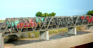

Another of my efforts. This one is based on a bridge over the Fraser River near Vancouver.
