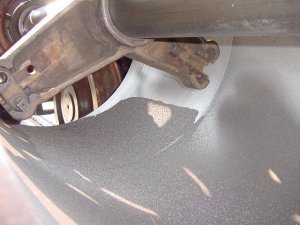

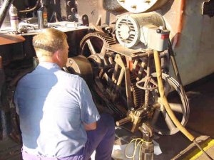

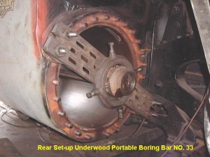

I find these photos fascinating, and don't believe I've previously shared them. The attached images were taken during restoration of a heavy consolidation (2-8-0 steam locomotive) by the Ohio Central Railroad. While the subject matter is interesting in and of itself, I have a particular soft spot for this ugly beast of a locomotive as I was a kid when my father and a couple friends purchased it in 1967 (I believe) for use (eventually) on a tourist railroad (Hocking Valley Scenic). In hindsight, I was fortunate to help with some day to day work on this locomotive back in the '70's - mainly limited to shoveling out the smokebox, cleaning the waste from the main driver journals, and other tasks that the adults didn't want (or were too big) to accomplish.
Long story short, if you've ever wondered how a steam locomotive's cylinders where freshened up, here you go...

Those are great! I love seeing pictures like that. Is that locomotive operational now?

Did someone have it in their toolbox, or do museums and rebuilders borrow each other's specialized tools that they have acquired over time? I know they didn't go down to Grainger's and buy that rig.:mrgreen:
I have seen a similar set up at a foundry's machine shop that was boring out the cored hole in a 48" dia cane roller and I have seen them in new old books (Lindsay Publications:thumb:), but not on a loco in color (like that really matters on a steam loco).
Glad to see that another steamer will get to run again. :thumb::thumb::thumb:
The guys that work for the OC steam department have been in that niche for decades. The guy that oversaw much of the work on this engine was also one of this locomotive's original purchasers way back in the 60's, so has had plenty of time to accumulate this kind of stuff - first for the Hocking Valley, and now for the Ohio Central. I think it's like any other specialty - you learn where to get what you need.

I suspect that what's happening in the picture isn't really boring out the cylinder, but actually machining the cylinders...getting them back to round after being a few hundredths or thousands of an inch off. Cylinders are castings.
I suspect you're right - just a freshening up. The cylinders are castings, but the bores are pressed in liners similar to what's done in some internal combustion engines. I'd be curious to find out if these are considered wear items that can be pressed out and replaced once they become too thin after multiple freshenings, or if that the liner were for all intents and purposes a lifetime item. A question for my father (or someone here).
