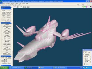

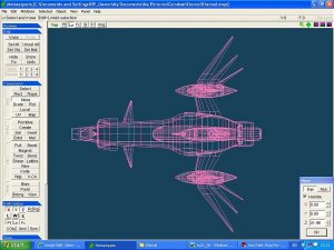

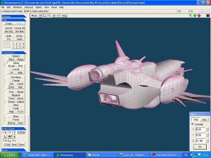

I just wanted to post a HUGE "Thank You" to Jay and all the members here who have shared info and tips on Meta.
This program has always appealed to me as the program I usually use(Truespace) has been somewhat lacking when it came to modelling more curved shapes or even fidure models. I wanted to switch to Meta but just couldn't come to grips with it.
Now, thanks to Jay and all the members here, I've been able to start a new project modelled completely in Meta! :)
There's still work to do yet but it's shaping up pretty well. It takes longer than it might in Truespace but I'm getting better results by far. For those wondering, it's the Eternal from Gundam Seed/Destiny. ;)
I also want to thank Claudio Dias who first tried to help me with this style of modelling, and Lex who's anime modelling tut' was also invaluable in getting me this far. rlc321 also get's a "thanks", working with him on his latest projects has also given me an insight into how these are modelled in Meta, AND for getting me hooked on Gundam. LOL
Sorry if this comes across as a hijack. I'm just greatful to you guys for getting this old dog to learn new tricks. :)
