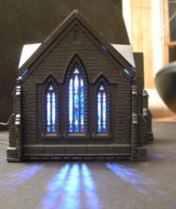

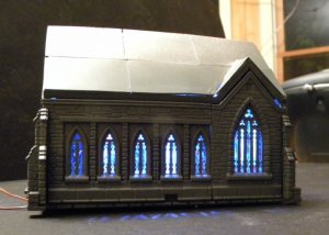

SML sgws#2.jpg SML  sgwnds#1.jpg I'm playing with the lighting. The photos are unsatisfactory, the windows look better in person. the flash overpowers the interior lighting totally. and in the longer exposures needed without the flash the windows closest to the LED's get washed out.
as you can there isn't much light leak. what there is is exaggerated in the long exposures.

Seeing this nice model "in person" yesterday at the RR club was a real treat. The stained glass windows have turned out beautifully. The LED lights are working out very well too.

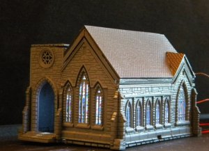

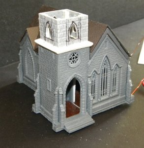

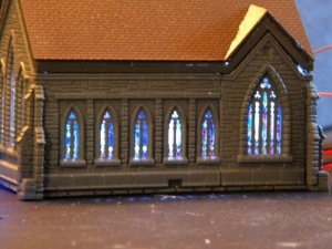

SML CH SG#16.jpg SMK CH SG#15.jpg I have an exterior roof made for the church, and have made some progress toward getting a better photo of the stained glass effect

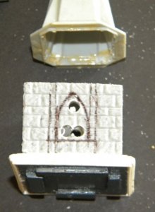

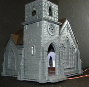

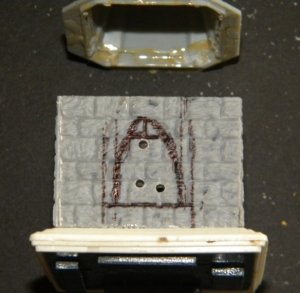

SML CH bt ext #1.jpg SML CH bt ext #2.jpg SML CH bltr ex #3.jpg SML ch bl tr ext #4.jpg SML CH bt ext #1.jpg SML CH bt ext #2.jpg SML CH bltr ex #3.jpg SML ch bl tr ext #4.jpg I have done some work on the bottom half of the bell tower extension. the stone is leftover from a Faller viaduct leg extension, the rest of it will show up on my narrow gauge, and at the planned spectacular Straka Gap bridge @ the club.
This piece of the bell tower extension needs a shot of dull coat after the paint is thoroughly dry . The arched window openings might get some kind of trim, possibly louvers, this section is removeable from the bottom of the tower, as will be the next section so the pieces will be easy to mess with on the work bench

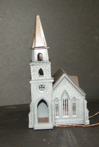

SML CH w bl twr.jpg bell tower on
I built the easiest of the bell tower options. it is removable, so I can try the others later if I feel like it. I'm not fully satisfied with this, but if I ad liked of the other two ideas better I'd have built them. it is removable I can look at it for a while, and if I think of something better I can build it.
In any case, there is a lot to do, the front door, it needs some ivy, and there is a bunch of interior detail that might find it's way in there eventually; but next I think I will work on getting it on to it's site on the RR, hook up the lights, work on the foundation some, and study it for a while in site, to see how it looks in Downtown Harlow

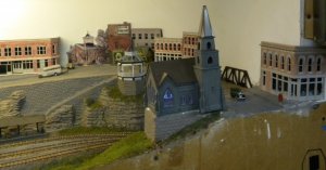

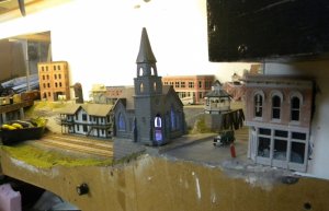

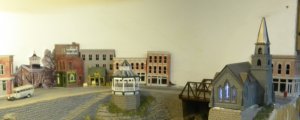

SML dnt Hlw w ch #1.jpg SML dnt Hlw w ch #3 .jpg SML dwt Hlw w ch #2.jpg Today I drilled a hole through the scenery to pass the wire for the lighting through the scenery. I ran a big run of wire up to the fourth level above Harlow, and hooked it into the lighting circuit .
Then I was done, My RR is in an attic, and I don't have the AC up there on yet.
The big black thing above the corner building in the middle photo is the bottom of the centralized control panel.
