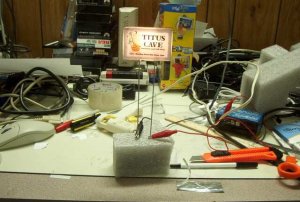

Back Lit signs can be made with a printer and overhead projector film. First you need to make your sign in the correct size to print and make it. This was made with a greeting card program and measures a shade under 3 by 2 inches. Smaller than this and they get too hard for my fat fingers. Also cut out a piece of white plastic (.030 or so) a piece of foamcore. Cut the foamcore as shown.

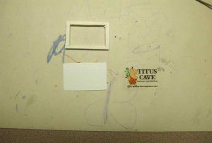

step2
Next tape it all together into a sandwich as shown with box tape. Then cut the opening in the foamcore back open with a knife. You will also need a piece of metal tube and a small 12v lamp. I used K&S 8100 Aluminum and a Radio Shack 7219 bulb

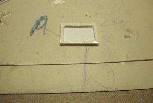

step3
I next cut the tube in ½ and mounted them into the foamcore with hotmelt. The bulb then just pushes in the tube and friction holds it and allows it to glow. Bend the bulb slightly towards the back so it doesn’t touch the plastic so it will not melt nor show as a real bright spot.

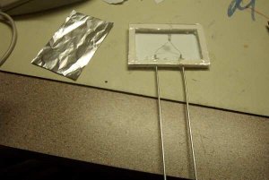

step4
Next cut and tape a piece of Aluminum foil to the back and band the sign with a strip of tag glued on with hotmelt. Paint and make it as nice as you want.

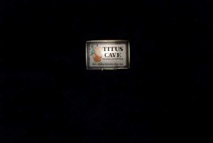

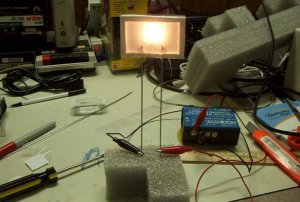

Here’s a lights on view.
Beacon in the Night
Here’s a night view. Feel free to ask any questions…DASH

Is the aluminum tube the conductor for the light or do the wires go all the way thru it?
OK 2 Q's-- If the alum. is the conductor, how did you attach the wires the the alum.?
The tube is the conductor. The bulb I used has aprox. 2 inch tinned solid wire leads. I bent a small hook in the end and shoved them into the tube. The tubes then press through the roof in drilled holes into a piece of foam glued to the "floor". They are then connected to the wallpack with alligator leads. I use those small plug in wall packs to power my lights. I have a source where I get them used for a dollar each. One could use brass tubes and solder, but that's more work with solder and painting and all. DASH
