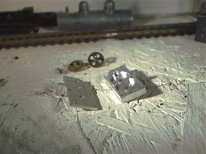

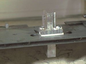

While running my MDC Shay for the first time in years I noticed the motor smoking and decided it's time for the rebuild I've been putting off.

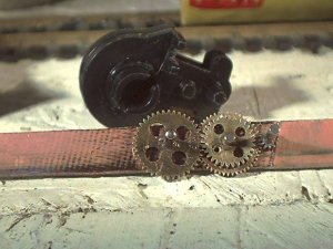

Among other things I wanted to change that noisy primary gearbox.
I located suitable brass gears from an old syncronious motor that would give a 5.5/1 reduction and the right spacing between the input and output shafts.

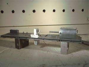

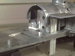

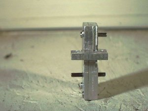

I got all the holes tapped, bushings installed, lapped the gears and did some testing today.
No more noisy gearbox. Just the purr from the Mabuchi can motor.
