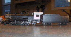

Okay so I have been playing with a scratchbuilt cab on a Bachmann Mike to do a freelanced back date on it. I have now made 2 attempts to apply an .015 wrap of styrene that I studiously embossed with rivets. The initial application looks good but after a few minutes the solvent cement starts to attack the .015 causing wrinkles and bubbles. Second attempt I used less solvent but with the same result. I was using Testors liquid cement as in my experience it tends to be the least potent of the ones I have worked with (plastructs and ambroid being the other liquids I generally use).
I have now had to re-sand the roof of my cab twice and I am not sure if my nerves or the cab roof will take another failed application. I know some of you apply styrene wraps to scratch built tenders with success so what am I doing wrong? the cab took a few hours of messing to get the roof line right and it looks amazing except for the missing rivet details.....
I do not want to give up on this!

Was able to get some good info on another forum... I was using too much glue as I was using the brush in the bottle. Used a nice soft brush and it went on great. Was able to continue with the sides of the cab and the smoke deflector.

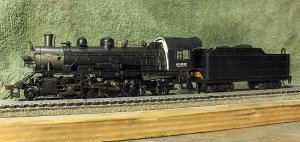

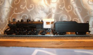

So I had an epiphany this past weekend (which Squidbait will tell you is neither remarkable or unusual) in that I was reviewing my locomotive inventory and found a Rivarossi heavy mike that I thought would look good with an all weather cab..... so out came the razor saw and .... hey wonder what that cab would look like on my current project..... well after a few hours of replacing the cab front and windows I decided to go with this cab instead. Now before you start brow beating me for bailing on my scratch build let me tell you that I promised myself I would not start building my new layout until this current project was completed.... well I just cut my completion time in half so the new layout is that much closer to reality... you can all forgive me based on that right??
Attached a pic of the new.. new cab. Now all I have to do is paint and letter... oh and install a Tsunami.
(please excuse the plastic dust in the images.... Squid: dont you even think about commenting about my lack of photography prowess)

Looks good, but I think you need to close up the gap between the engine and tender, and maybe extend a footplate from the cab.
Otherwise, not bad. I still would have liked to have seen you finish and paint your scratchbuilt one... I think it would have looked pretty good too. :thumb:

I have created the new drawbar and the tender is positioned much closer to the loco. I now need to break my piggy bank and get a medium steam Tsunami and a big A** speaker to go in there. Notice QSI has a new high bass speaker that I may have to look into.
Still going to do some work on the pilot, remove those silly builders plates, and paint.
Is that lump on the foot board supposed to be the power reverser? may have to replace that with a casting if it is.

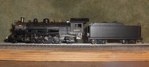

pretty quiet over here these days.... been posting updates on that other forum but thought I would update here as well. Blew a coat of paint and tossed on some custom decals I had printed by El's trains... still a long ways to go (weathering and sound install) but I like the way it looks!.. for some reason I cant upload a photo here (probably a firewall issue) so here is a linked image
