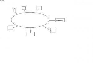

I think I understand you need to wire everything in parallel. So the last light in the line isn't dimmer. Physically how it that wired?

Run feeder wires from the power supply and then separate wires to each lighting group from the feeder wires.

It depends how elaborate you want to get. Basucally, you could get by with one switch for everything. A SPST (single pole, single throw) switch would work. If you want to control individual components, I would suggest building a control panel and installing individual switches for each unit. Maybe even a master fuse in the panel. The panel would be where you route your feeder wires to, from the power supply.
Yes, it gets the idea across. Traditionally, wire diagrams are angular things, with no curving lines. Theres a whole system to drawing them. Symbols for lights, switches and each type of component. You might want to find a book at Radio Shack that tells you how to draw them if you are interested in going that far into it. You could also just add the second wire from the power supply to your diagram to make it a little more clear.
