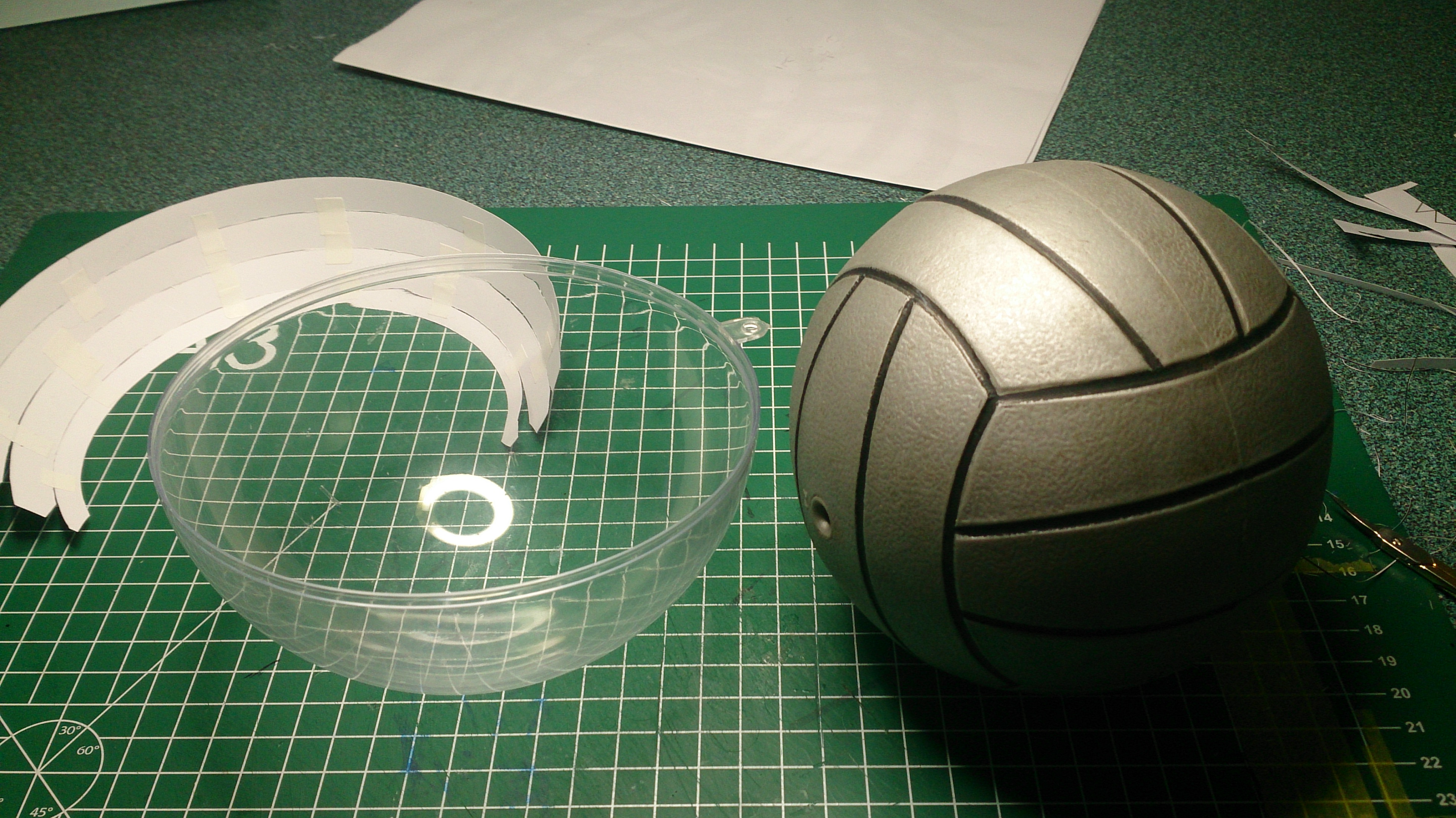

As a reminder, this is what I am working for ....... A smooth ball.....
I said "BALLS!" to my original build of the spherical command sphere, and started again.
I wanted a smooth ball, at least...:angelic:
I wanted something a lot better than what was before.......
The 'Stepped' effect of the parts just did not work for me........ (But, maybe that was just my crappy building skills way back then ......:yuck:)

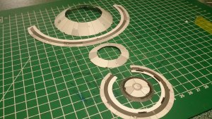

I did not modify the printed ring structure for the command sphere, except to remove the tabs.

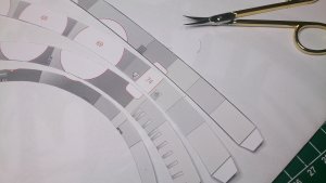

In removing the tabs, you are left with a thick black line around all the parts. Removing this black line was important to achieve a seamless/smooth ball.

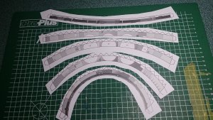

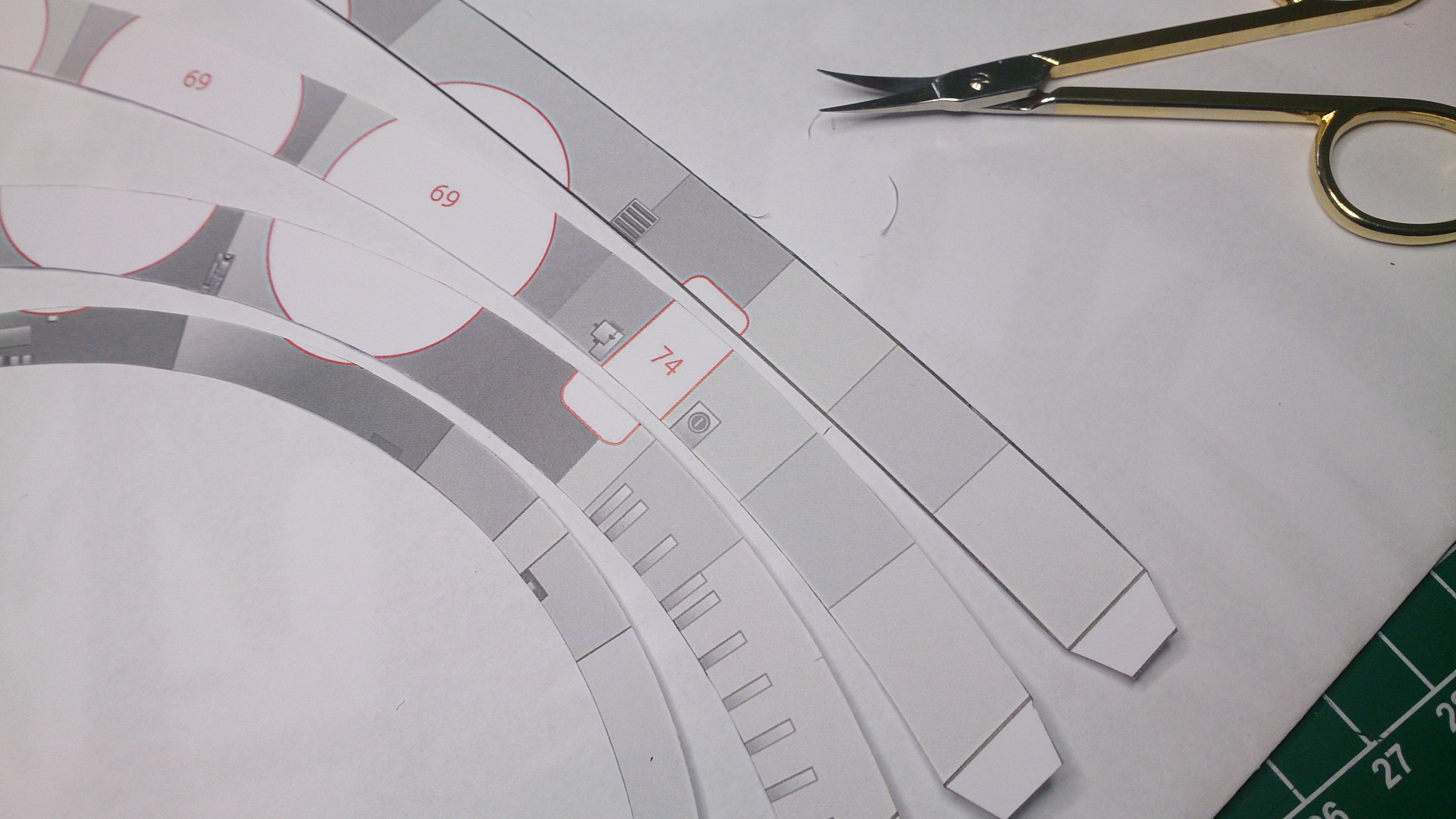

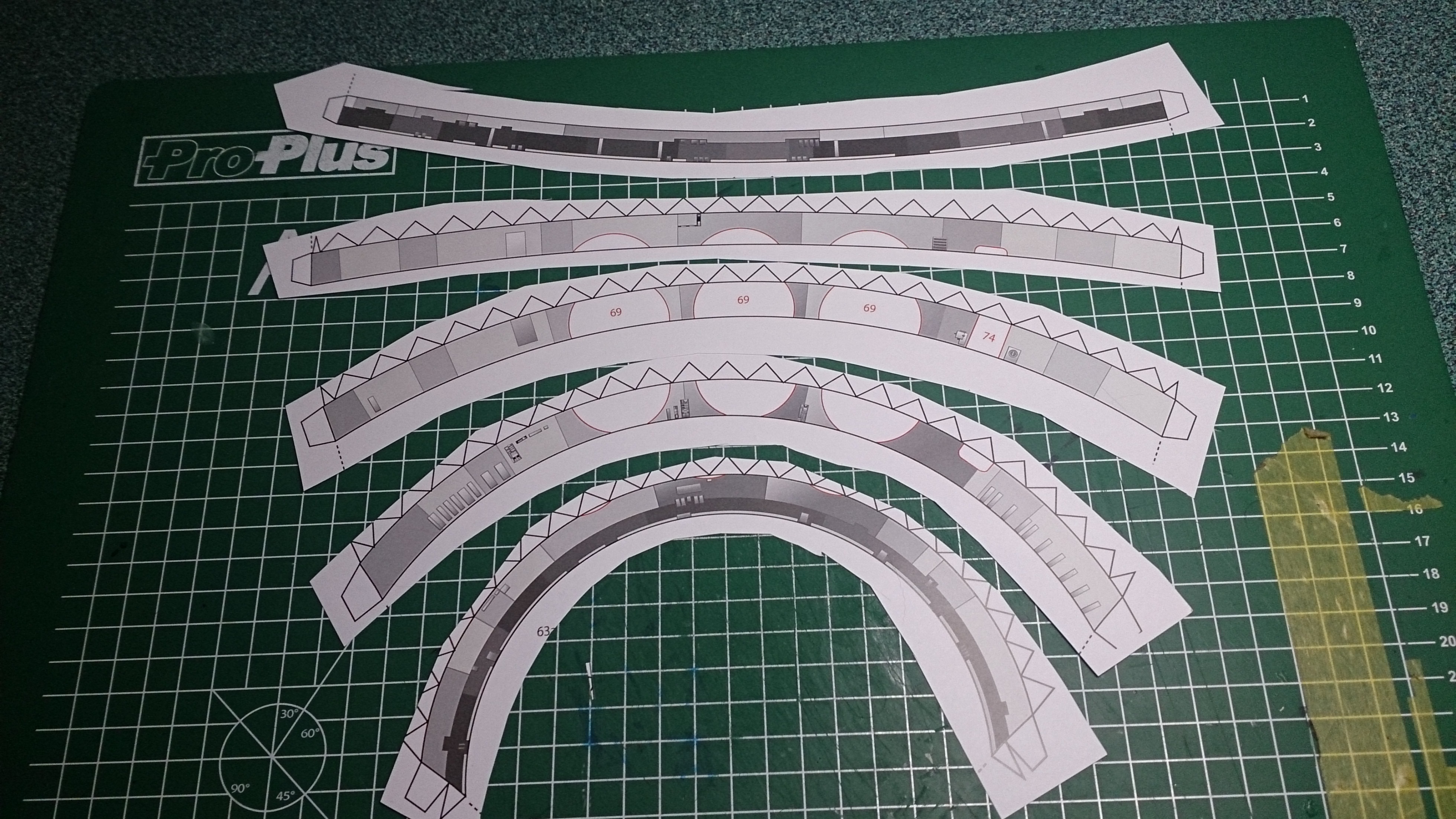

All the parts for the lower half of the ball were rough cut....
Close trimmed....

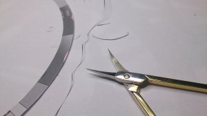

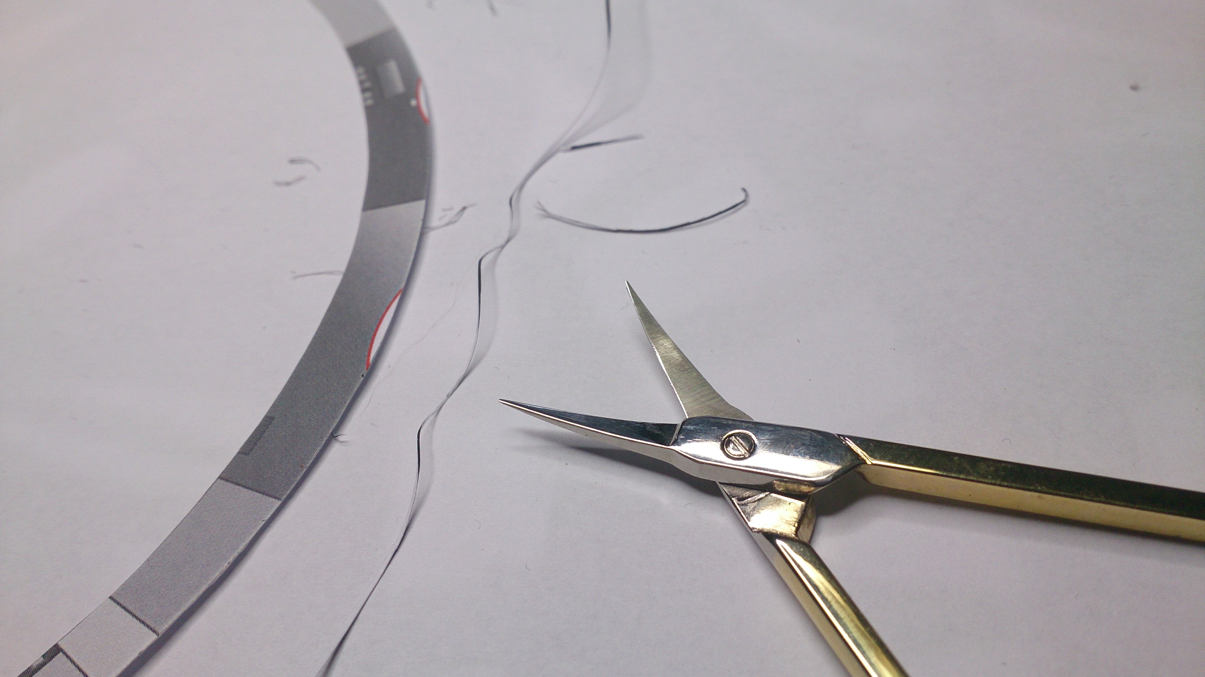

And methodically, using extremely sharp scissors, the black line was trimmed away from each part....
Getting this part of the whole process accurate and correct is crucial to the end result.
Trim to pixel level with your scissors... o_O

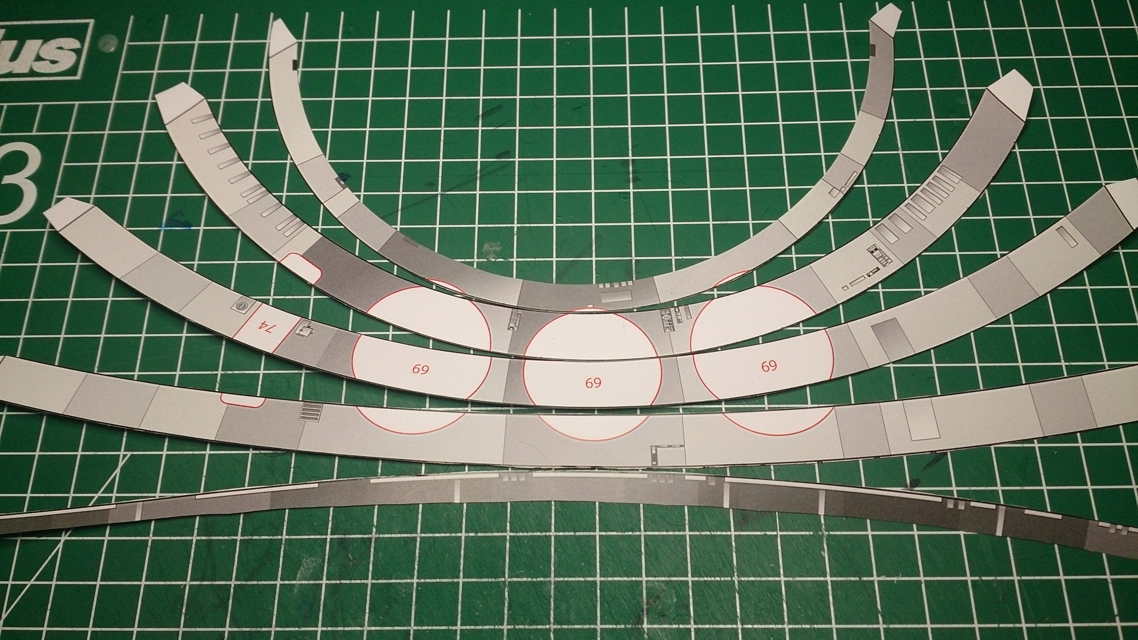

The piece on the right is un-trimmed of the black line, the others are in various stages of trimming.....

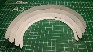

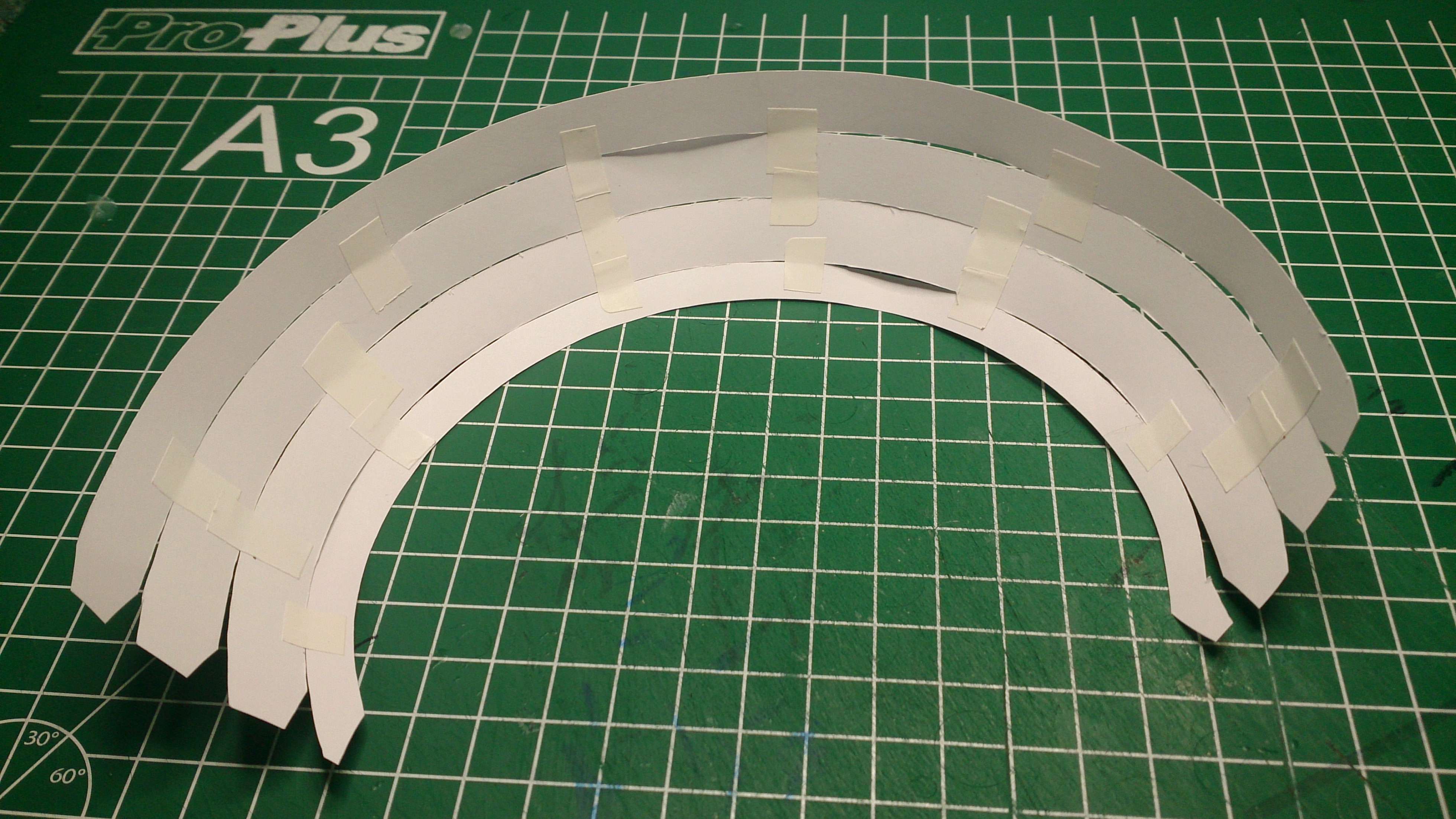

Once all the pieces are trimmed to perfection(!) I then used the printed texture lines as a guide to tack each strip roughly in place...
Long ago, in this thread, @zathros gave me the right idea; Water shaping.......
And that is where the fun begins.....
As seen earlier in the thread, I purchased various plastic Christmas ball type decorations that I could possibly use as a form, to form the shape of things to come.....
As it turned out, the internal diameter/circumference of one of the plastic balls, matched the external diameter/circumference of the model command module almost perfectly.....!!
One thing I can say I have learned with this project, is there are endless items around the house that can help you in paper modelling.

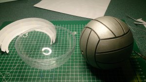

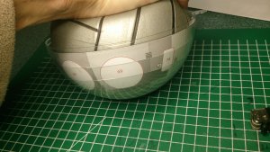

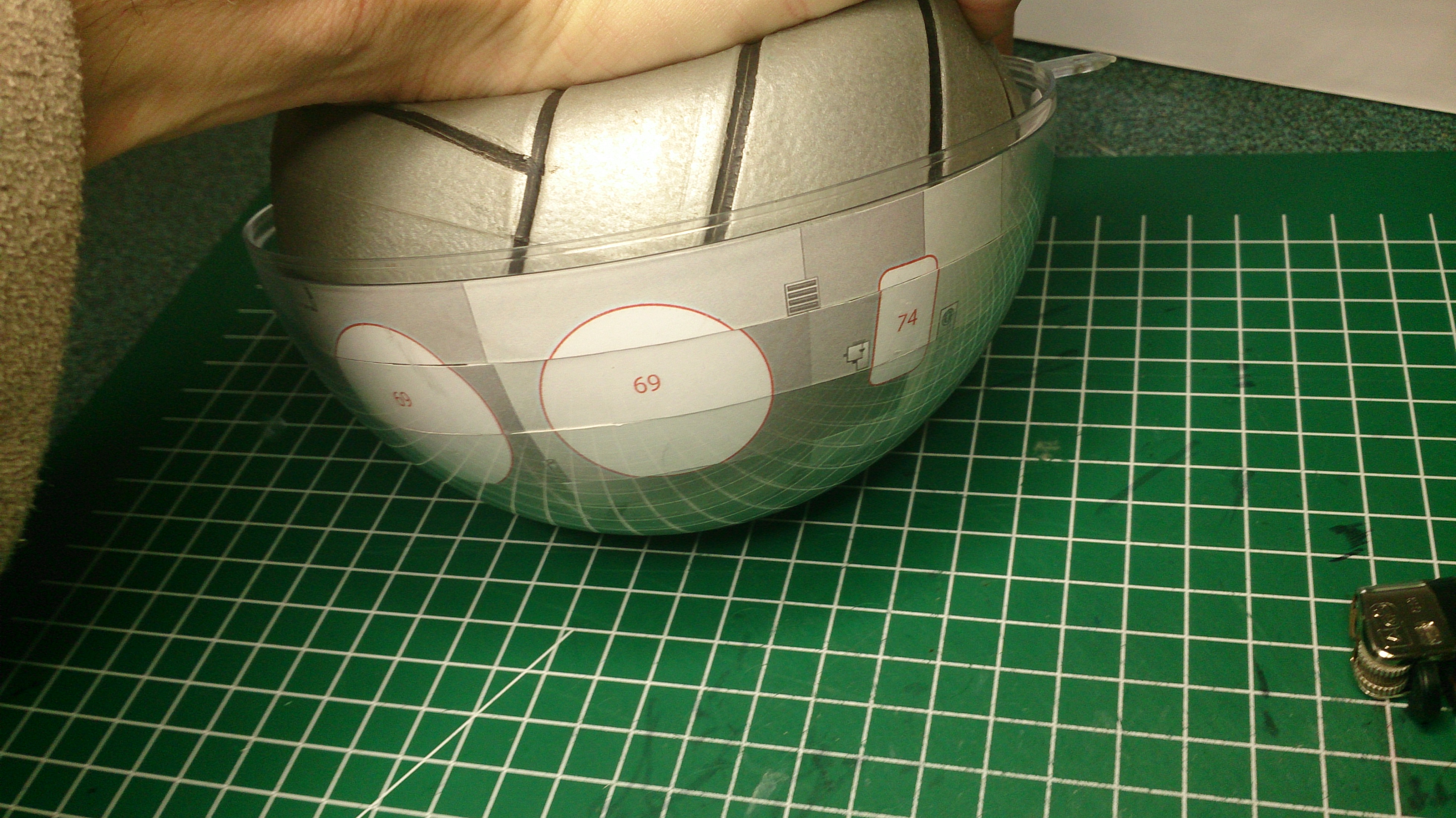

And these worked for me ....... The afore-mentioned half of a Xmas ball decoration, and a semi-inflated kids plastic ball.....
I lightly dampened the back of the tacked together ring structure with a bit of water, applied with a damp cloth. This was then placed into the half of the plastic ball shell. The toy ball was then placed into plastic shell and pressed down with force.
This pic gives you the idea.....
Once I was happy that everything was sitting correctly, I applied a heavy weight to replace my hand, and left it all to dry over night.....

Also, all the parts have been 'water shaped' as outlined earlier. When dampened and placed into the plastic half ball, the semi inflated plastic kids ball is pressed down into the shell with force. This causes the kids ball to expand outwards, compressing the paper part against the plastic 'half a ball' shell . I placed a very heavy weight on this and left it overnight to dry. Once removed from the shell the part now has a curved profile matching the curvature of the shell.

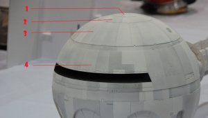

Each hemisphere of the sphere has 4 distinct longitudinal sections divided by darker recessed bands.
These 4 sections are shown here (this photo was taken at Wonderfest 2008, and judging by the texturing on the model, I think this is where UHU02 got his inspiration from.)
Sections 1 and 2 are made from 1 piece each.
Section 3 is made from two bands joined in the middle.
Section 4 is made up of 4 separate bands.
Sections 1 & 2 are simply two rings. These are joined at the ends and then water shaped. Simple.

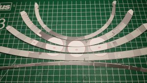

As shown earlier, all the parts (bands) of sections 3 & 4 are tacked together roughly and then water shaped.

The strips I cut to about 6mm wide x 15mm long. I started joining the bands by first accurately lining up various printed texture lines and sticking a sticker strip behind. Doing it this way ensured that the texture lines lined up across the bands. It was then just a case of filling up the spaces between with strips until all the bands were joined together.
It is important to make sure that the join is as snug and tight together as possible. As you progress you can 'feel' the paper pulling itself into form. It is a case of letting the paper take it's own form without forcing it. Of course, having the parts pre-shaped helps immensely while doing this.

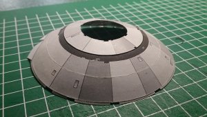

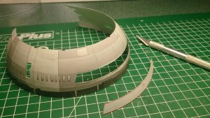

This photo shows the parts for the top 3 sections of the sphere, pre-shaped and joined ready for final assembly.

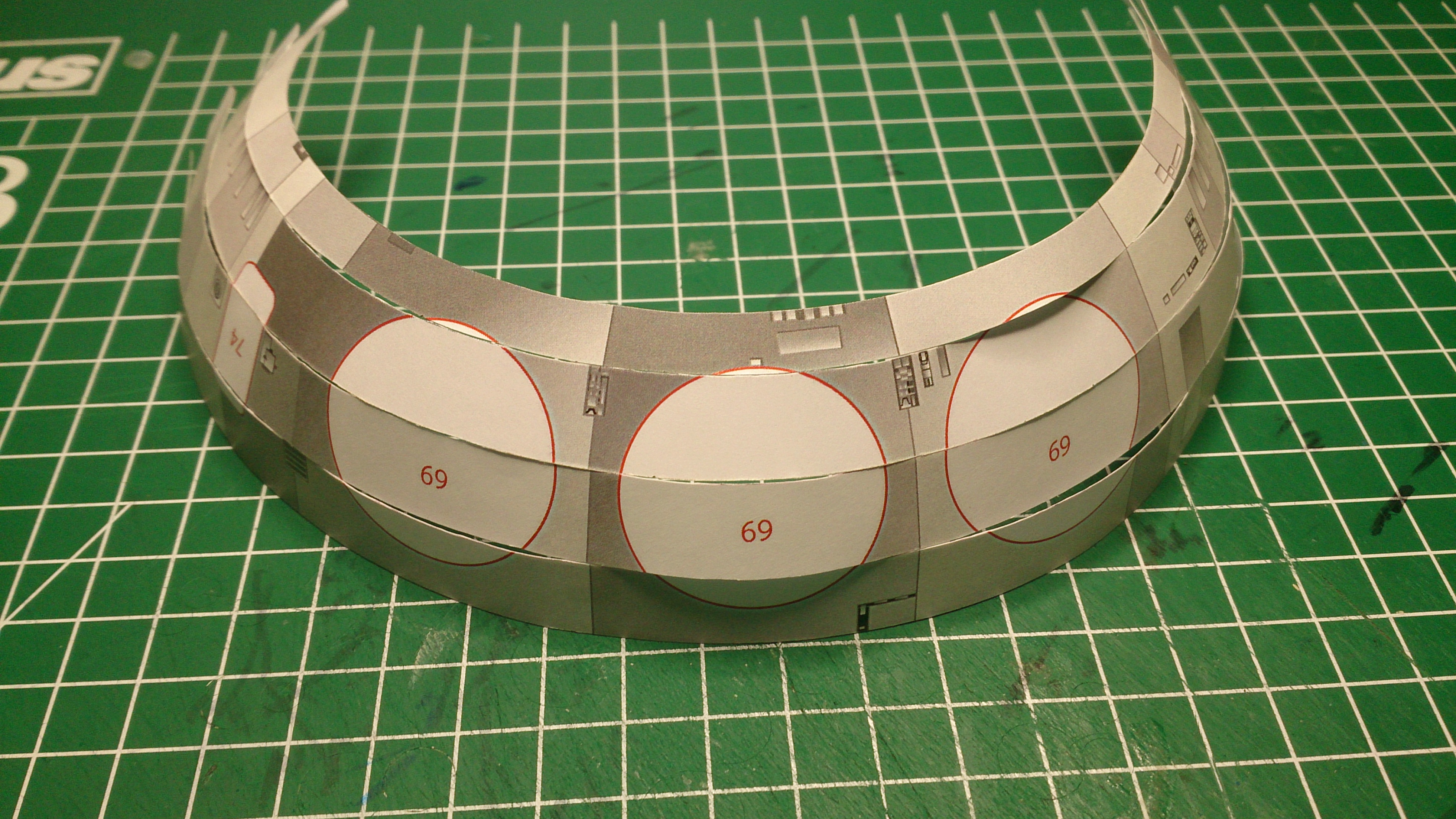

All the notches on the edges of the rings were cut out before assembly. The black bands were cut and trimmed from spare copies of parts sheets. These black bands are to be recessed lower than the main panels.

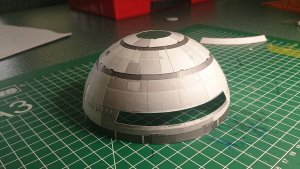

This pic shows the (almost) complete upper section. I left off the top most part (section 1) for now, as the resulting hole provides an entry point for a finger or thumb when assembling the parts. This I will attach later when the whole hemisphere has been assembled.
The shape and form is looking nice and round and smooth!!!
The main section (4) was assembled next, in the same way.

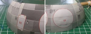

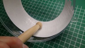

You will notice in the pic above that the join line of section 3 is a bit rough. I overcame this problem by burnishing the join from behind to flatten the join more. This was done by placing the assembled part into the plastic shell that I used for water shaping and using a rounded wooden handle to achieve this. As the plastic shell is clear, you can watch what you are doing and where you are burnishing by looking at the surface of the parts from the outside.
This pic shows the difference between burnished (left) and un-burnished joins (right.)

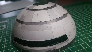

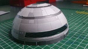

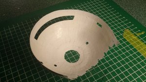

Once I had completed the assembly of section 4 of the upper hemisphere, I used the plastic shell as a support and very carefully cut out the opening for the windows, ensuring that the cut lines were perfectly straight and that all the red print was removed. I also cut out holes for where I am going to add recessed detail to the surface later on.
I then joined section 4 to sections 1,2 & 3 to complete the shell of the upper hemisphere.
This pic shows the 'sticker hell' on the inside of the assembled shell.
And, ladies and gentlemen (and others,) this is the completed upper hemisphere.
I am VERY pleased with the end result.
