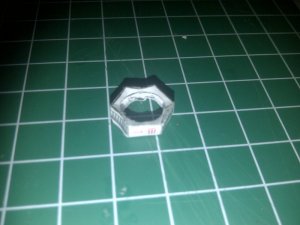

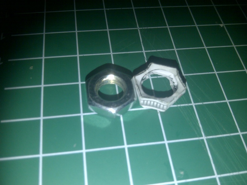

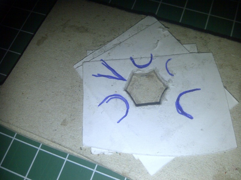

CLICK!!! 3 earlier (a lot earlier,) years of Production Engineering experience switched on a brain-cell somewhere screamed: JIG !!!!
So, spending most of the evening and 2 attempts to get it right (I think), I made a simple jig, in the lateral shape of the nuts, out of a few laminated pieces of thick card. I made sure that all the curves, angles and straight edges were 'spot on' at the bottom edge of the hexagonal 'pit'. That should give a good firm, square, correctly shaped form to push against when gluing down the tiny tabs.
Using the 160 gsm paper, I used the jig for the second attempt.
The system worked really well for the gluing process. Until I tried to get the nut out of the jig............... The model is card, the jig is card, the glue is white glue..... You dont need to be an engineer to work out the result.
Muttering to myself in frustration (already) ,and looking for more rolling papers, I suddenly thought of a colleague of mine from long ago, who's nickname was TEFLON; Because nothing stuck ....
"What a silly **** I am!", I exclaimed. SILICONE !!!!! Not a lot sticks to that either, AND it is waterproof (marine grade). That should solve the problem of the glue soaking into the jig and gluing the nut to the jig.........
So, here is a pic of the jig, now coated in a thin, well worked silicon 'shield'....

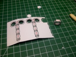

I'm plodding away at the spine, doing a few of the damn nuts, a few couplings, and doing some other sub-assemblies to break the repetitious boredom of the spine...

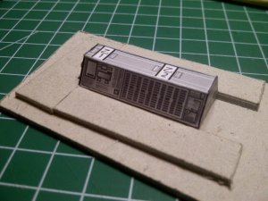

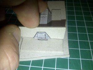

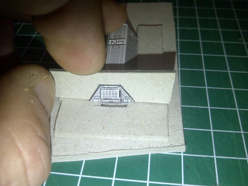

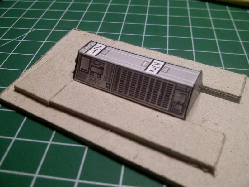

I started a few of the fuel modules, and again made a jig to speed up the assembly process, which works really well....
I really want to make sure that all the modules are exactly the same and perfectly square. I think if there is any 'waviness' or un-straight lines on the spine, it will stick out like a sore thumb. The jig should help to achieve consistency in the modules...
The two edging pieces on the bottom are cut to the exact angle of the two small side 'rails' along the side of the main face of the module.
I made a former to place at the end of the module to hold the faces true and in shape whie gluing the end cap.

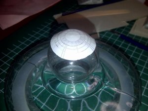

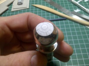

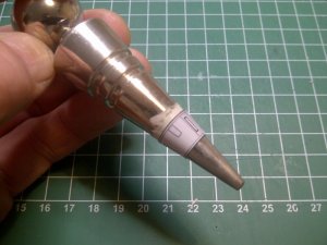

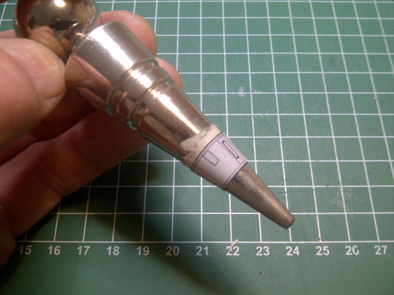

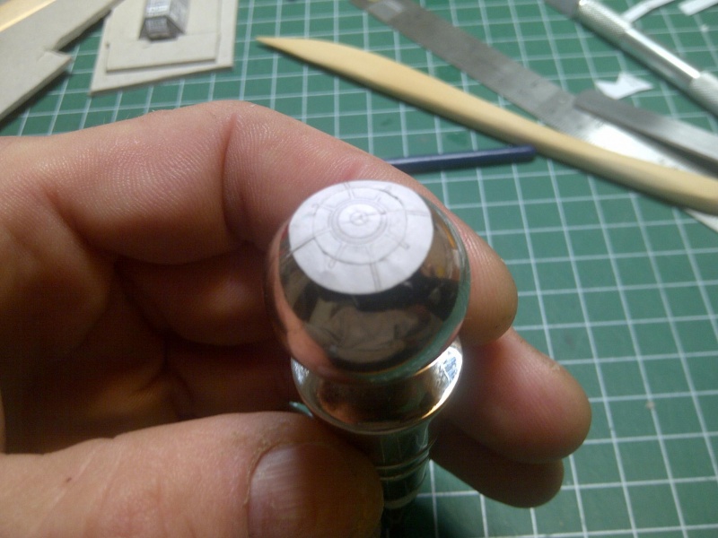

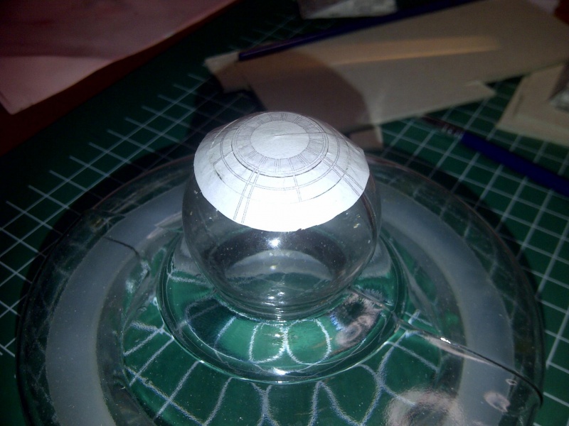

While I was making the cone shaped connectors for the spine, I found something in my kitchen that works really well as a mandrel for the cones......A modern wine bottle stopper!
And to please me even further, the ball at the end of the thing has the exact profile of the small dishes in the radio array.......
Ha, and to add to that, a top from a glass storage container, again from the kitchen, is perfect for shaping the main dish .......

Did you wet that dish to get the shape? If you use a printer with pigment ink, you can get away with that (make sure the ink dries). I love to see people sharing their technique. I am not a paper purist. It would be silly to all the time and effort into a model that would sag and fall apart. Use all and everything you need to make it come out right. UHU used a wooden dowel. I would consider using pipe. That would give you the option of running wires and lighting later if you become so inclined. :)
Pipe..... (And not the type you smoke with!!)
Instead of a wooden dowel, I used an 8mm aluminium tube/pipe.
It is lightweight and incredibly strong in comparison to a dowel.
I dont think I will be having any 'sag' problems with that. (I say, hopefully!)
Dishy!
The dish I formed dry.
The dish itself is comprised of three paper rings, and due to the accurate design, it seems to form the correct shape naturally during the gluing process.
But, that one was just a test. I will try your suggestion and see if the end result is more satisfactory! :thumb:

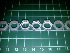

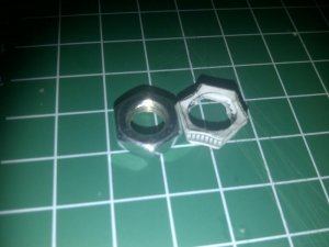

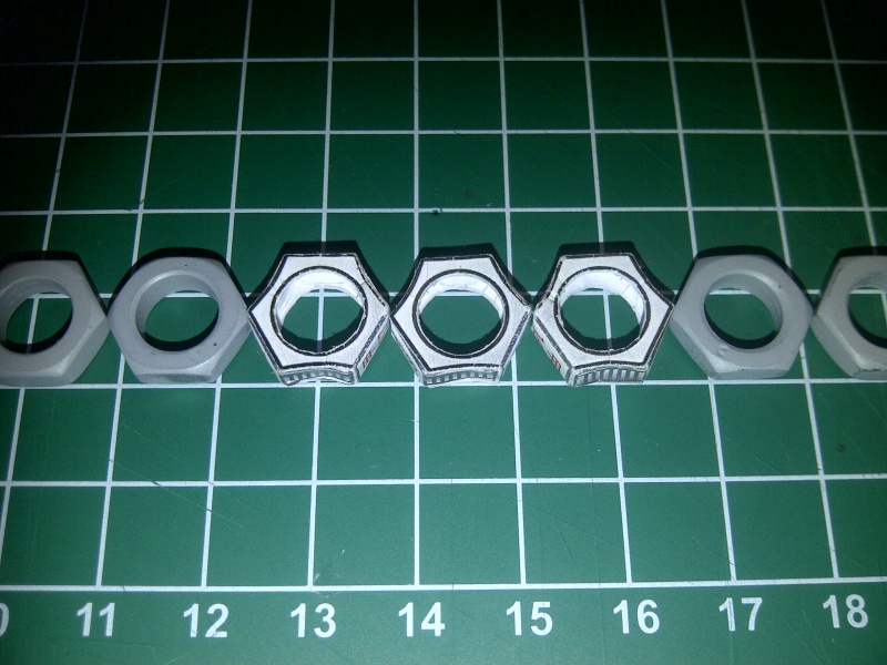

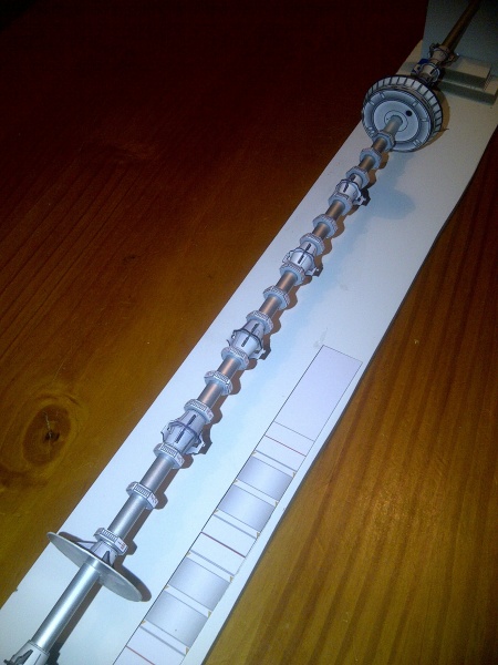

As I mentioned in an earlier post: I think with this model, the spine has to be modelled linear perfect, otherwise any irregularities or un-eveness will stick out like a fart in a perfume bottle!
I have tried to make the nuts in various weights of paper, but I am still not satisfied with the end results. I think it is mainly due to my inexperience with this medium. :oops:
I am still playing with the idea of using the M8 metal half nuts instead.
The temptation is extremely great to use them, because it guarantees that the spine and fuel modules will be linear perfect.
But, 'That is cheating!', I hear you cry.
I know, I know......
But, I sooooooo want this model to be right, after waiting so many years to model her......
(On that point: Is the Discovery a 'Her' or a 'Him' ???? Most ships are duped 'Her', but HAL was a him.......!!)
In the pic below, you can see what I mean. I spray painted the metal nuts with grey primer. I am gonna make a few modules using these, and see how it looks .....

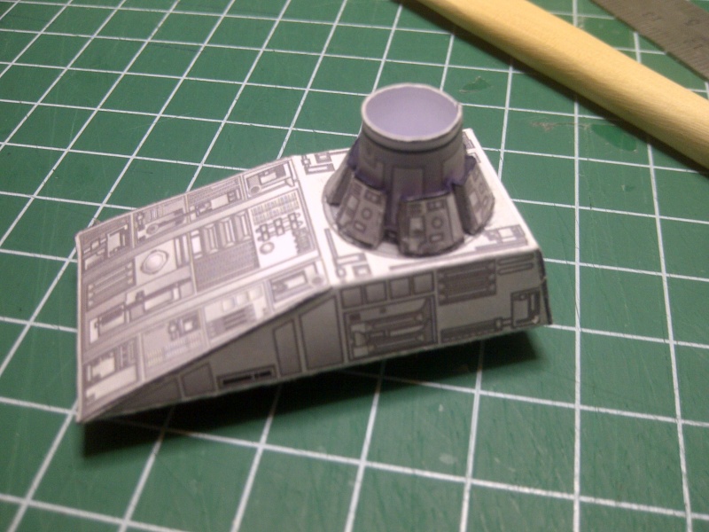

I started on the main module for the antennae base....

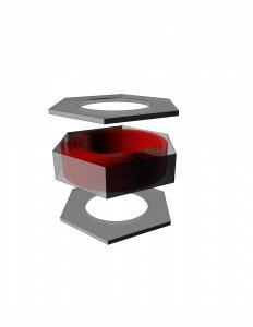

Should my nuts be empty, or full of something ..... ?
Mmm, good idea on the insert, will give that a try.......

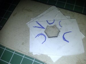

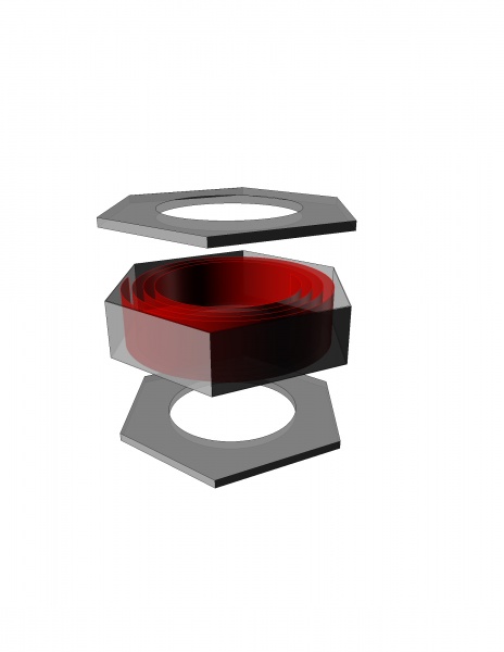

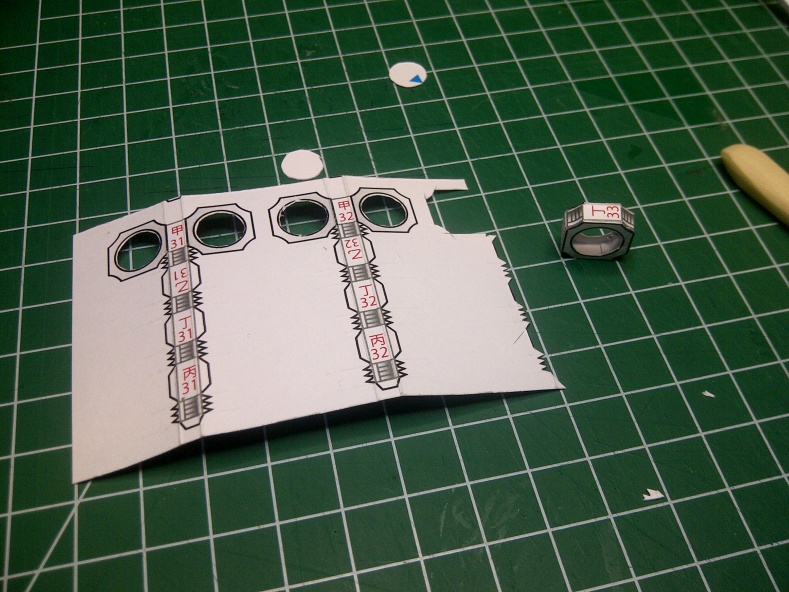

I tried various weights of card on the nuts (100 gsm, 140 gsm, 160 gsm and even 200 gsm).
I tried using 200 gsm for the faces and 140 gsm for the sides, but it seems that once the hole has been cut out, it weakens the face and is prone to collapse.......
I'm going nuts here................
Potential life expectancy issues......

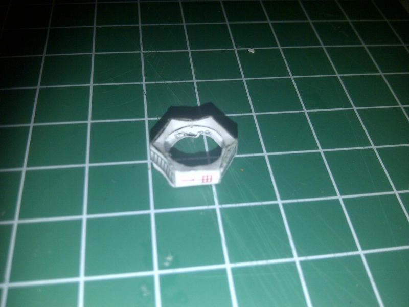

OK! I put my hands up in frustration here... Which I really do not want at the start of this ....... These nuts are making me nuts.... wall1
I've tried fingers, thumbs, fingers AND thumbs, tweezers, wooden pokey thingies of different shapes and sizes, different weights of paper, beer, a jig, different states of consciousness, more beer, swearing, moaning at the good lady for complaining that the first thing that she gets shoved in her face when she gets home, is me and my nuts...... (She should be so lucky ... sign1)
I just can't seem to get the consistency that I want to achieve....
I think the main problem is lack of experience in this medium, but this project has a steep learning curve....... :cool:

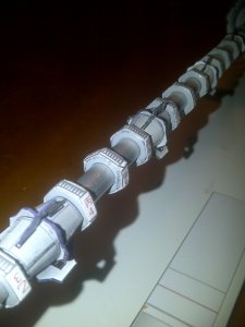

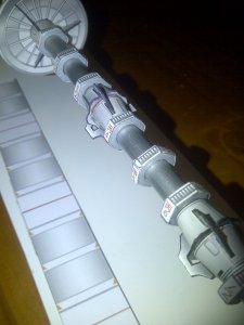

As I've mentioned repeatedly, my biggest concern is linearity of the spine. To me, it is the end result under the display case, that counts....

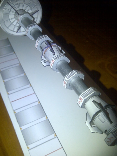

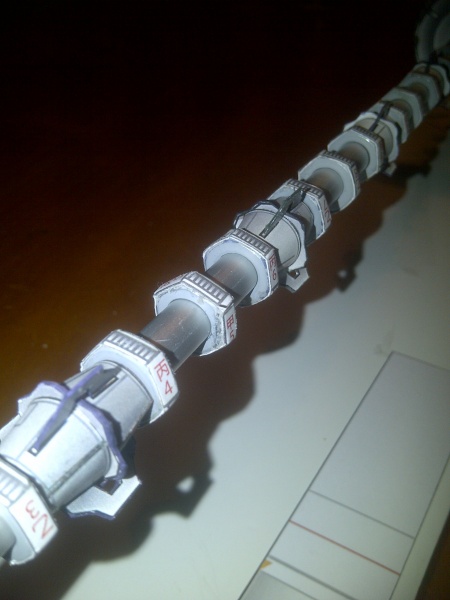

So, as usual lately, I have been mainly playing with my nuts, and doing some test and/or final assemblies, of the couplings and other bits and bobs.
As mentioned earlier, I hand-sanded each individual metal nut and sprayed them with grey primer. While these were drying, I used 80 gsm paper for page 2 (which contains all the nuts) and cut out the strips of the nuts without the tabs or the side faces. I then glued these to the side faces of the metal nuts, and burnished the paper onto the nut with my fingers and mainly thumbs.
The end result looks acceptable, but can be bettered.
Please understand that the pics below are not final build, but just a quick throw together to understand how it will look....
All constructive critisism is welcome .... :-)

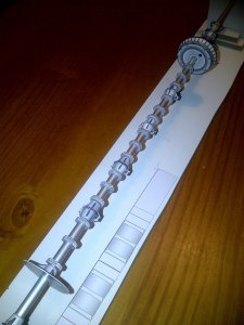

I am quite pleased with the similarity of the printed spine wraps and the aluminium 8mm tube, that I am using instead of the wooden dowel...
Here are a couple of other shots for your perusal......
