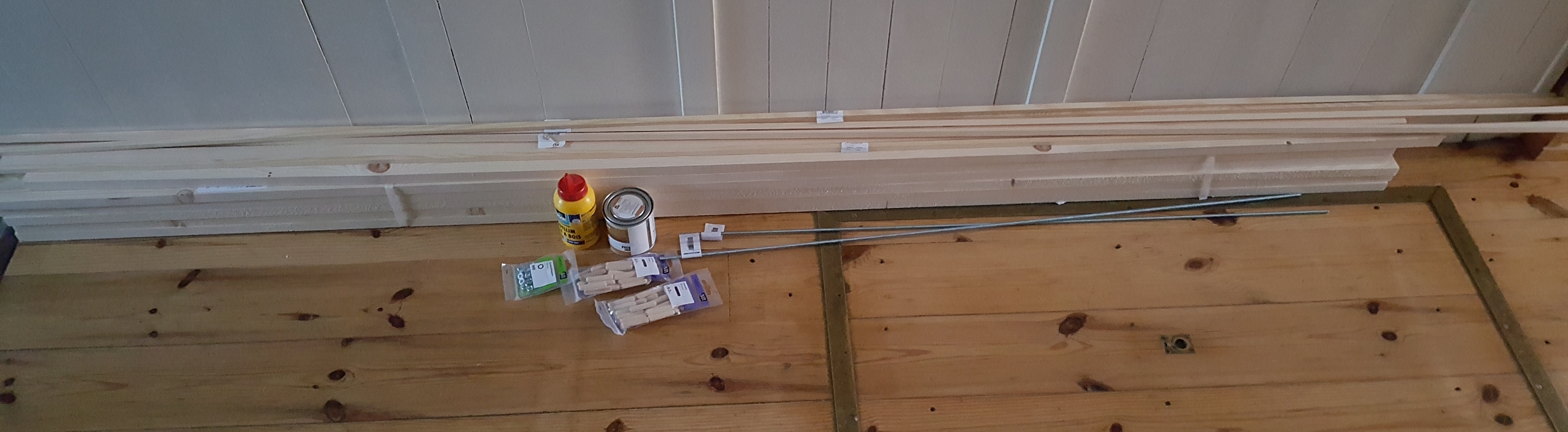

Stocked up with nearly 70 euro's worth of supplies, necessary for the display case project....... Paper is wood, right?

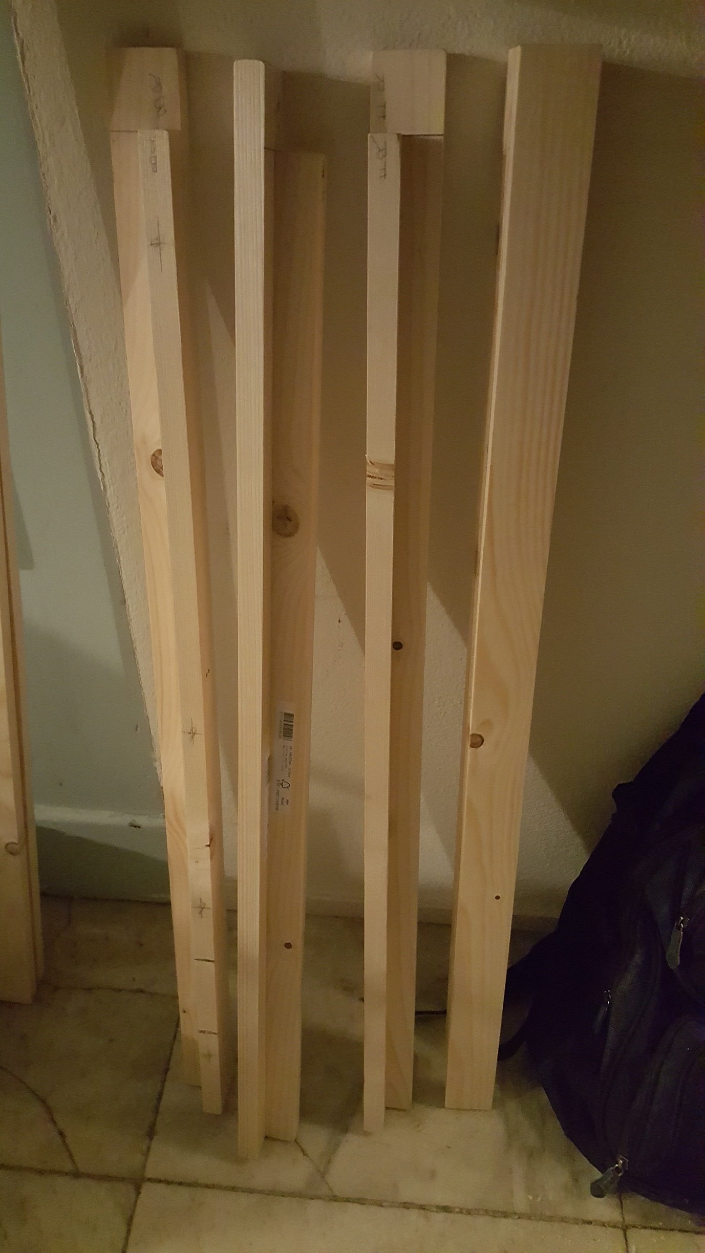

I've made some progress on the construction of the frame for Discovery....
All the parts were cut to size following my sketches....
All the joints of the construction are doweled and glued, no screws or nails have been used so far.......

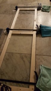

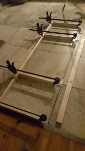

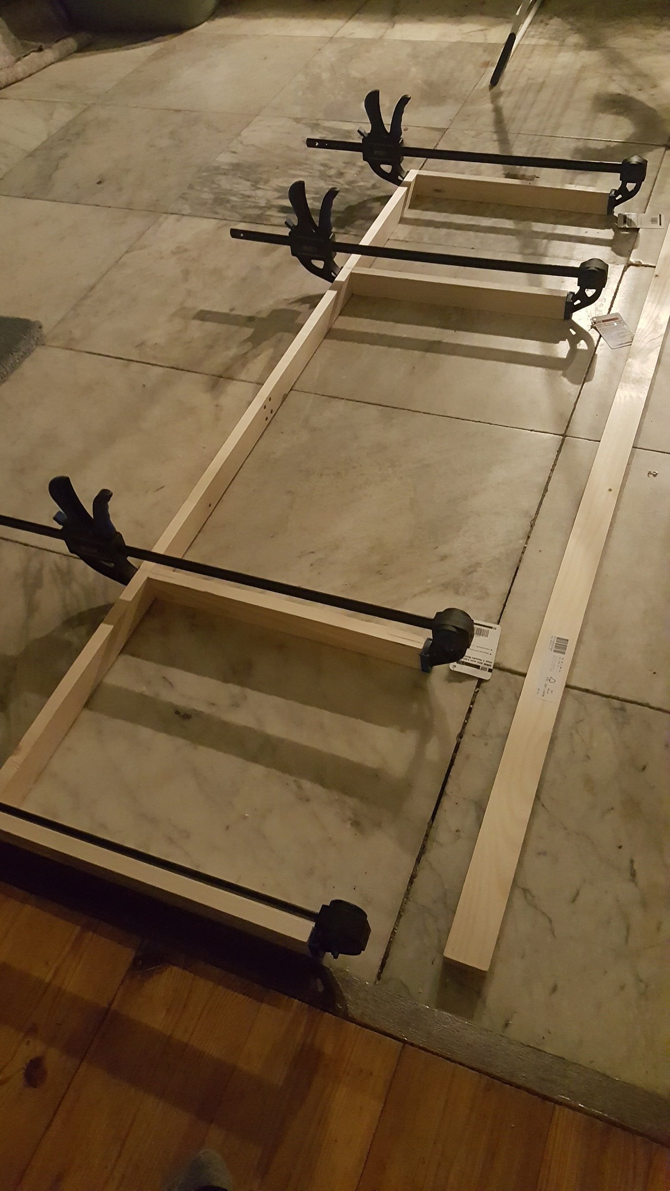

The central shelf was made up first. The dimensions of the frame were based on the two pieces of glass, so I wanted to get that right first.

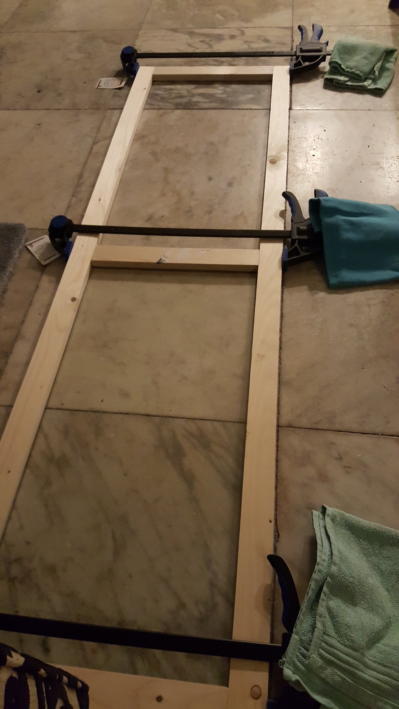

The flatest surface I had to work on was the marble tiled floor of the kitchen. I put the towels over the ends of the clamps to remind me that they were there, to avoid injury to my bare feet and the loud swearing that would accompany it.... :cool: ;)

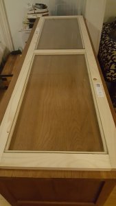

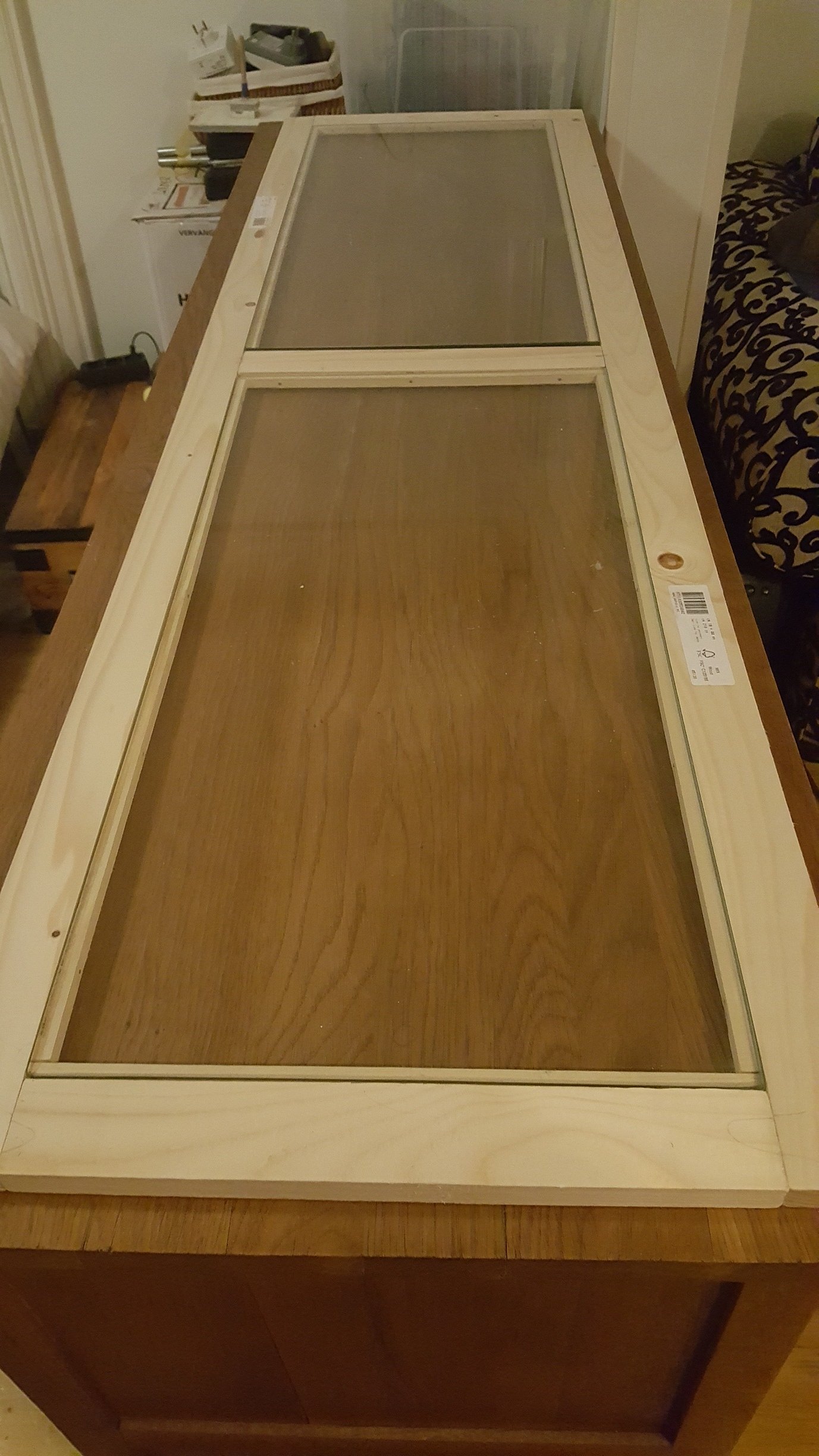

Once that had dried overnight, I added 9mm square beading for the glass. That pretty much completes that part.

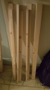

The legs were assembled ready for attaching...

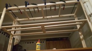

As I speak, the gluing up process of the main frame is in progress. I'm hoping to get that all done tonight.
