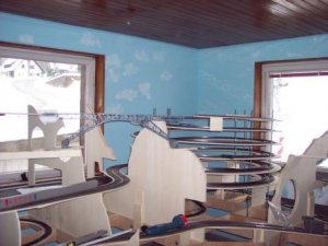

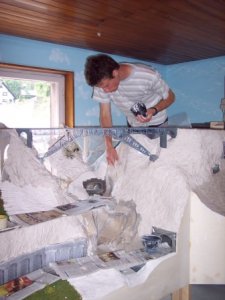

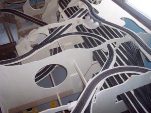

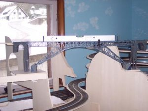

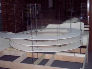

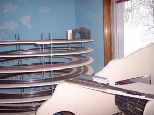

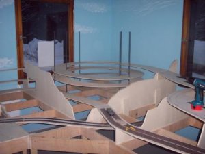

i got some pics of these guys in switzerland and i just thought id show them to get some thoughts, basically just to show the elevation thy have on their layout using helixes and stuff and wondering whether you guys think i could achieve this sort of elevation in 16ft x 9 ft?

i would love to plan up something like this but rather than the european look id go for an american or canadian sort of scenery. in it i would love to have some sort of coal/mining operation and or logging. i want the coal/mining/freight mainline stuff so i can run diesels and then abit of logging so as some steamers would not look out of place.
anyways just let me know about your thoughts on elevation please, bed time for this sydney boy :)

Interesting pictures...! You can probably do this type of thing, if you set aside about a 4x4 square in one corner for the helix.

Did you take the pics, or are they somewhere else on the web? I'd love to see more.
Also, your minimum radius and maximum grade will be determining factors for just how much elevation you'll be able to acheive on the layout itself. As for helixes...well, you must decide if one will do the job (point to point with one end on each level for multi-level) or if two will be needed, and recognize that trains will be hidden for a while, out of sight. Your trackwork must be absolutely bulletproof.

yeah it wont be easy and it will take awhile to work out but this is definately the sort of thing i want to do,the pictures are taken from some guys in switzerland not me, i just found the website whilst looking up one of those bridges shown in the picture from the walthers catalogue, ive been looking for a layout like this for awhile for inspiration.

A 4 x 4 in the corner won't be nearly enough room for a helix. That would give yo a maximum radius of 23 inches, and even with the thinest of subroadbed, you would have an excessive grade to try to get up the necessary 3-31/2 inches per revolution around the helix. I'm not that good with the math, but I think you would need a minimum of 6 x 6 to get a helix in. That would make 25% of your space dedicated to helix. In 16 feet by 9 feet, I think your best bet is to design the railroad as a big around the walls helix. I'm not good with drawing or graphics, but I'll try to draw a word picture for you. Suppose you imagine 2 "folded dog bone" layouts stacked one above the other in a "U" shape so you can walk into the middle of the layout. Both ends of the layout would be big enough to allow return loops, so you would have 2 return loops one above the other at one end of the layout. The front track on each dogbone would run through a valley with mountains in the background, and you could have various industries worked off the front track of both levels. When you get to the other end of the layout on the bottom, the track would turn back to go along the back wall of the layout, but instead of returning to the point of origen, it would start to climb to the second level. If your space has 2 9 foot walls and 2 16 foot walls, you could make the entry off of 1 of the 9 foot sides, which would give you a 9 foot wall and 2 16 foot walls to use for the climb. You might even suspend a single turn helix like the Tehachapi Loop halfway between the 2 levels and double the space available for the climb. Put passing sidings on the climb to allow for meets if running more than one train.

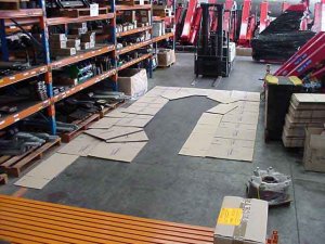

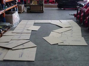

also i layed down some cardboard at work today to simulate some possible bench shapes, i guess it was the only way i know to see it to scale,its not a bad piece of software actually, its callled 1:1cad4d :rolleyes: :rolleyes: :D
anyways ill show what i had,im pretty certain i want to do this u shaped folded dog bone thingy! :) it seems like a good use of my area and a good way of getting out of the normal loop island which i was never keen on.
in the second picture you can see a bulge on the left bench are halfway along where i placed a box , this is to represent a possible spot where i was thinking i could possibly fit the Tehachapi Loop you were talking about to try and get some quick elevation.
also was thinking that the bottom left as you look at the pictures would maybe be where a yard/town/station sort of area might be and that the layout would ,ove down the run climbing into mountains and finding a mining/coal operation somewhere on the right side of layout, and i dont know what could realistically fit into this layoutas im a newb but id also love a little steam run logging branchline/operation around somewhere, and a river cutting through mountains or perhaps running alongside what would be the front track as you look at the photo .
anyway off for some missus time now and sorry if my ideas suck im just trying to get creative and brainstorm and stuff,
also thanks to russ for you comments and everyone else youconfirmed my want of the u shape design with your words of wisdom.
also tho i have not totally given up the use of a smll helix yet but im sure you guys will show me why this would be a bad idea in time .. (im ust curious about minimum radius's on helixes and maximum grades acheivable ..
il shut up now catch ya later :)

I like your 3d model of the benchwork - great idea! ;) Russ is right - I just threw out a number, but obviously the bigger the radius, the easier your trains can negotiate the helix grade. His "around the walls helix" has also been described as a "nolix" - and there is quite a bit of info on this concept at www.trainboard.com.
As for the math for the helix - if the minimum clearance needed is 3.5", and your maximum recommended grade is 2%, you will need about a 28" radius (or 56" diameter) to stay within these parameters.
