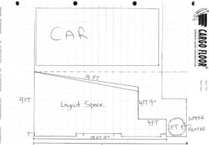

hi guys,
im back but this time no hanging layouts :) , i took all your advice and i scrapped my hanging layout before i went too far. i've now freed up some available space in the garage.
The only problem is that im pulling my hair out trying to work out the best way to use it, I figured if i showed you what i have to work with i could probably get some help to try and utilise the area the best. ill post a dodgy sketch to get the ball rolling and please ask what details you guys need if you ge interested, ps i got my timber and the lot so this really is killing me as im raring to go. :rolleyes:
anyway heres a start,
just some info about what i want to do with this space,
dcc controlled
using flextrack
want to have at least one loop on the track at 22" radius curves otherwise probably 20" even possibly 18" radius for the rest.
I want elevation across the layout also i was hoping for mountainous scenery and multi level track, bridges and tunnels.
small to medium yard more for storing unused trains i guess but would also be nice to be able to run a little diesel shunter around rearanging trains abit too.
continuous running is a must as i have a two year old boy who loves to watch the trains go round.
A "G" or "C" shaped layout seems to speak to me for that space. Do you have John Armstrong's book on Operations? In it he describes what shape of layout fits in what size and shape of space, given your scale and druthers. I'd think about a walk in "G" shape, with it being wider towards the upper right, as you can access both sides of the board easily.
The maximum that you can reach into a layout for rerailing trains is probably a little more than the length of your arm, if the layout is at a low level. If it isd shoulder high, you can probably reach a little less than the length of your arm. That would mean that you ar going to have to have center access to any layout you build in that space. The "C" or "G" shaped open type layout mentioned would work. If you want an enclosd design, you can build a moveable bridge section like a draw bridge or swing bridge to allow you to walk in. You could do a duck under to an access hatch, but if the layout is build low enough for a 2 year old to view it, it will be too low to even crawl under. Also as we get older, the duck unders seem to get lower; and we have difficulty getting down and back up again!
One possibility that would give you a nice long mainline continuous run would be to do a sort of egg shaped "Q" with the tail at the water heater. The draw bridge could go in the span where it is marked on the drawing as 4ft 9". You could put a small industrial facility in that peninsula at the water heater and a continuous run arond the main part of the space.
Schematically, I'd make a large loop with a center operating pit.
As far as radius, you've got room enough to go far wider than 18". IMO, make them as big as you can get. 30" would easily fit. You will never regret making your curves broader. Especially since you plan to run this in loops for your kid to watch, trains just look better and operate better on broader curves.
Then I'd stick two "towns" where you can do things on the layout. One would be up front along the front side, the other back against the back wall. These are the longest legs you have to work with so it makes sense to put the towns there. A siding, some industries, whichever you like; it'll give you something to do when you get bored with running in loops.
To make use of the funny peninsula near the water heater, make a branchline. Start it on the righthand side and curve it around and have it run along the back long wall, and end in a stub set of tracks serving some industry. A coal mine, a lumber mill, something. If you provide no runaround up there, you have a convenenient excuse to continue to use cabooses -- the shove up the hill would need one for protection.

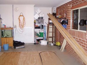

thanks for the replies guys, lovin the input , tommorow i will be swapping the internal garqage door around to swing in to make some more room once thats done im onto the benchwork ,probably looking at starting next weekend.
well the door is changed so now i can fit my car on the other side and my layout space is available, that means i can start benchwork this weekend coming only problem is "the plan" is no where near complete :)
galen i have ideas but nothing concrete yet ,im debating whether or not to start by building a 3ft bench rectangle strip along the 15ft run which is along the wall right up to the garage doors, im pretty keen on a horshoe design with a continous loop and im kinda figuring i can adjust the wall strip making it fatter where needs be and bolting on the other L shape part once i have a final plan. maybe im jumping the gun aand should wait for the final plan first but im so keen to get going, what do you guys think??
the thing is i want to make the underneath of the layout storage and if i get that strip done i can put stuff under there to make more rrom for more building, im just not sure anyway im off to spend some time with the missus i guess i have this week to work out how to start , any more input you guys have on my progression is much appreciated :)

If you need to build the under-layout storage, go ahead and do that. Try to plan it so you won't block possible supports for the layout itself. But as far as building the layout benchwork, I'd be hesistant to do that until you know your design. If you made a simple loop setup all on the level, sure, you can just put in supports and plywood. But what if you decide to build something with a decent grade? Then you'd want open grid, and may have to go back and rework the benchwork a lot.
