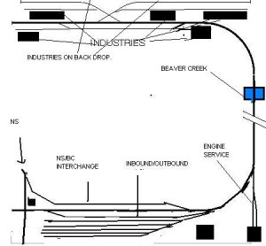

I like the idea of a return loop for your plan Val. Train Clown's first diagram really appleals to me as a solution. Nice graphics, btw TC! I see a lot of staging advantages over a point to point scheme and you'll also be able to send a train out and back from the industrial switching area if you want...the closest thing to continuous running. Sometimes its just fun to watch a train move. :)

Val Here is one idea of many base on your plan...The engine house/service area is optional.
Thanks a lot Brakie - it looks great!! I like the way you worked in an interchange with CN, although I'm going to change that to the CP track and the yard is CN. I also like that I won't need a small fortune in turnouts!!
:thumb: Val

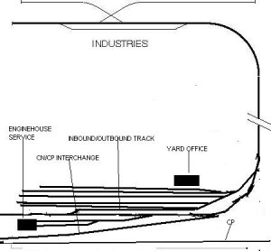

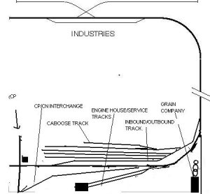

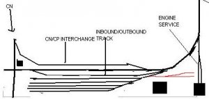

A little more about the Beaver Creek Ry.The layout concept is totally Vals..I just added 3 different yards ideas for her to mull over..
Now while I was doing the yards I started to think how I would improve this layout to my tastes.Being a big short line fan I wanted to see what I could do in that regard using a point to point design like Val's since I like that open running between the yard and industries since this puts "miles" between the two points.A very clever idea.:D So the Beaver Creek Ry was born.
