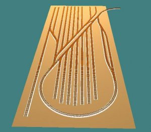

Soooooooooo, here I sits and doodlin' around with 3rd PlanIt.
I came up with a couple of idears for ya.
First one is the simple one.
