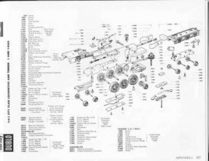

It has an odd design: the motor is part of the frame casting - the armature and worm ar mounted vertically. The brushed go through the frame -- one is grounded by the mounting, the other is insulated.
There is an adjustable bearing at the top of the motor that can be turned by a screw driver; don't do anything to this unless you need to.
There is a small ball bearing (single ball) at the bottom of the worm shaft -- this was missing on mine and the commutator was a little low for the brushes.
I think I have an exploded diagram somewhere.
Our local expert also remagntizes motors. The test for the magnet is a six-inch steel bolt with a bunch of washers and nuts on it -- if the magnet picks this up, it's OK.

Thanks a bunch. If you do have a diagram can you send it to me? Thanks. It is gorgeous the paint and the decals are mint the box is near mint and comes with all the original thinks ie: the manual, the triang tt coupler conversion kit.
Exploded diagram
Mike: I'll try to attach the diagram, if it's still readable after the compression.
This is the HD sheet and covers two and three-rail versions.
(If no good, PM me and I'll send a larger version)
