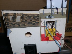

A week ago my grandson had a failure of a remote control robot like device; a sad story, but a reason to dis-assemble the entire machine for "parts we can use later!" This gave me the use of a VERY small can motor with a gear on the shaft. I made a hub in plastic that could be press fit on the gear and then attached a 4 blade rotor made from thin but stiff clear plastic, CA glued it to the hub/gear. Tests showed we had a working rotor. I then used styrene sheet in two thicknesses,plastic tube, rod, and aluminum flashing to build the basic chopper body with a bulkhead in the center and a hole on the floor to hold the motor/rotor assembly. Picture 1 shows this....

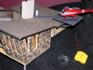

The second picture shows the complete chopper, the landing pad attached to the roof of the house, walkway, hole in the side of the house for the switch, the battery pack, and switch, etc.

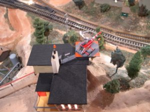

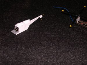

The next picture is a view of the house held on the side in a vice. Wires lead from the chopper bottom, through the pad and into the house, the battery is in place, the switch is press fit into the wall of the house. All wires now need final connection. None of this<except the switch> is visible when the house is in place, and you really have to look close to see it.
The final view shows the house in place, looking over the tracks, and the blades of the chopper whirling away!. I needed to use some fine wire to hold the skids in place on the pad; the motor torque tries to turn the chopper! Adds a neat touch.That part of the layout is about 30 years old; you can see in the picture that some of the track is brass. A fun project!!!! Dave
