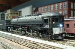

You're welcome, I've always had a place in my heart for Rivarossi. They were state of the art for their day, "poor boy's brass". The flanges are the reason I stick with C100 rail, Pennsy in the 1950s used rail that would scale out to that so I lose little sleep over it. Here's a parting shot of it with its newly installed super bright LED headlamp, from this past Tuesday, rolling thru McCue City on the club layout.

Thank you. I wish my layout was a little larger so I could run a "Cab Forward" like yours. It sure looks great. :thumb:
Wish I could say the layout was mine, I run it on our club layout. 36" min. radius, approx 1000' of mainline, a 4 track, 6 level helix from one level to the next with over 400' of track in it alone, 100+ turnouts, 2 double ended 8 track yards over 20' long...sigh :rolleyes: ...I do wish I could say it was mine ;)
