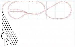

sputnik said:
...As long as there is no wall against the bottom of the layout (at the end of the yard), a possible alternative would be to move the engine facility to the lower left corner of that extension. Then have the yard tracks run at an angle along where the turntable currently is. You would still be reaching aways to operate the yard, but it would be closer, and you won't be reaching over the engine facility. Also, the yard tracks would be more consistent in length.
I've sketched this out on the first picture.

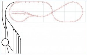

... If you wanted to minimize the reach over factor, you could even move the yard tracks to be parallel with the front edge of that extension.
And I've sketched that out in the second picture.
Both of these are rough sketches, to give you an idea of what I'm talking about with arrangement. They might not fit the same when you lay things out exactly with whichever planning software you are using. To get the angles I've put in those sketches, you will have to use some short curves after the turnouts. But this is when you try all sorts of things.

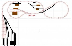

Jacob,May I submit that you start over with a new plan? As it stands now even with the "improvements" you are still face with a stub end yard where you will need to back in/pull out or pull out /back in.Not a very good situation if you wish to have trouble free operation.
Here's my idea.I eliminated the turn table/round house since its not really needed unless you plan on running steam locomotives and added a diesel servicing are with 2 stall engine house.I also added a inbound/outbound track with a runner track that can get your locomotives to and from the engine service area.I also added two passing tracks and added industry and town area.
