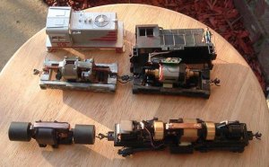

In the upper left of the picture you'll see a first generation Atheran/Globe motor in a Hustler. The one to the right has been remotored with an A-Line kit and wheelsets replaced with NWSL dropins. The motor on the bottom left is a second generation motor and the lower right shows a third generation mounted in an SW1500 that I'm about to install DCC into. On this one I've replaced the wheelsets with JayBee scale 40" replacement nickle-silver wheels all the way around.
