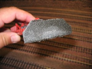

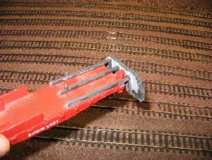

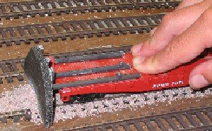

The ballast flat car is nothing too special. It does however leave behind close the final amount of ballast after a few passes and it is spread evenly. I mounted the foam to the front of the car with sprew pieces from a plastic kit - I super glued them to the top of the flat car. The foam is glued to them with PL300 foam adhesive. I positioned the foam so it pressed down firmly against the tops of the ties then removed the profile of the rails with a sharp knife. I had to tighten down the truck mounting screw on the flat to minimize tipping from left and right. It looks a little worn now but it still works pretty well.
