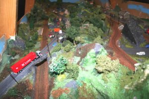

trying to post another picture just for the crack. All the bridges and tunnels are made from pieces of wood covered with car body filler sanded then etched with a small engraver. The back boards will be made of photographs eventually. We decided to build the lay out on an indication of no where in particular but with a West Highland theme thats( why the roads are so narrow ). We make the trees from anything and everything.
Dry food dye works with fine dry compost which we have ground to dust.
The layout comprises of real stones, box packaging, bits of wire, wood and cardboard which had plaster poured over it.
We don't go with any particular Ideas just keep trying different things till were happy.

Incidentally the lay out is 16ft long but very narrow. We Started just after Christmas 2006
