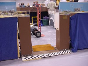

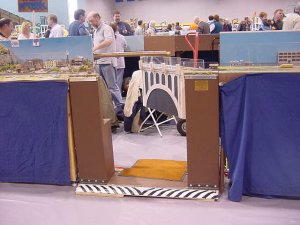

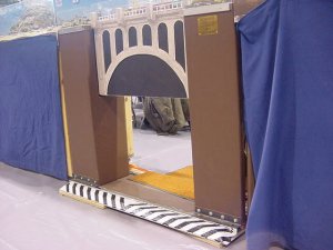

Here are some pictures of the walk-thru-module I constructed and posted some time back. My club, the Valley NTrak of CT, has now used it sucessfully for our last four shows.

Belg, I did wire in a magnet/reed switch to a relay that opens the outside rails on all the three lines. (red/Yel/blu) Continuity on the modules either side of the bridge will be broken when the gate is open. Depending on the length of the module, normally four foot, this gives the train plenty of stopping room, even for several slot car racers in our club. However, I have to rework it, the proximity contact switch will close even if the gate is not closed completely. Was thinking on the lines of a mechanical button switch that will only close if the latch is securely in place. After every show my knees thank me, should have made it sooner.:D

The modules are in storage and I cannot readily get a picture of the mechanism. Basically a "NC" reed switch is mounted on the latch tower of the gate - it will stay open as long as the magnet on the gate is in proximity to it. When the magnet moves away, the switch closes, engergizing the relay. The relay has four poles, three are wired NC and one is wired NO. I had a loud annoying buzzer hooked to that contact, everyone hated it so I've unhooked the buzzer. I am thinking of changing to a mechanical button type switch. A barrel bolt on the gate is used to lock it into position, it would be an easy fix to mount a switch that is actuated when the end of the bolt contacts it. We had a simple derailment because a member did not close the gate completely and since the magnet was in the vicinity of the switch everything was powered.
