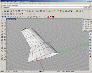

Still making am making "baby steps"! I did a wing following the steps describe by Steve Sanvito over at RhinoWebsite tutorial page. I wonder why it wouldn't "unroll"? ... The wing is done by Sweep2 using as rails the wing leading and trailing edges with the rib (top) as top curve and wingtip "point"' repeating the process for the bottome surface using rib(bottom)curve.
Expert advices from the Gurus and Wunwinglow is very much welcome and appreciated.. Regards to everyone...
Muhammad

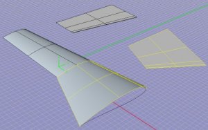

Split the rails so you do make the surface in two pieces. Then unroll each one seperately. Imagine trying to unroll that whole wing as one piece. It wouldn't work, it has to be split where the change in trailing edge occurs. Rhino has the same limitation, at the moment anyway!
Tim P

Tim .... Thanks a lot... I'll keep it in my notebook to do just that. I'll work on it tomorrow. It's past midnight and I can take the needed rest (sleep!) now the Guru had spoken!! Thanks, again

Hi Folks,
just a quick note on surface orientation. If you have e.g. a wing surface like above, check the orientation with analyze - direction. Press f for flip if the arrows do NOT point outwards.
If the arrows point outwards and you unroll the surface, the outerside will be facing the top (arrows pointing upwards).
To distinguish fron/back left/right of difficult unrolled parts, I always place a tickmark at a distinct place on the surface before unrolling.
If you keep checking the direction during design, it makes things easier.
