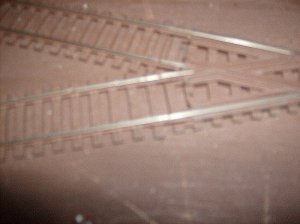

Here is a blurry picture of Atlas c100 flex track and an Atlas crossing on my layout. All I do is cut the tie plate off with a razor knife and carve a littile recess where the rail joiner is, and then cement in place with white glue after the track is in place.
Loren

Cool nomad, it is blurry but I get the drift. I'm using a foam base so the notch should be easy. I am so excited, I just got my package from ups. I now have enough track to do my current project. 15'-4" by 22'-4" room. I'm put a 16" shelf at door height. This is the main start of my layout. I'll be taking pics for sure. I'll be asking for a lot of help also.:wave:
