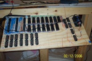

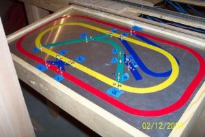

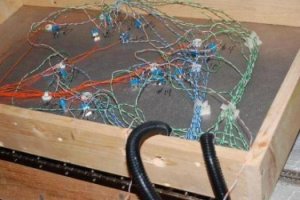

Cat 5
I used Cat 5 cables for everything except the bus wires. I ran Cat 5 wires to the switches and the remaining 4 wires were tied to terminal blocks under the top near the switches. I then ran the terminal blocks back to the main board to another set of teriminal blocks for later use for lighting or accessories. I did run the swithes back to terminal blocks also and then to the control panel which made it easier to hook up the snap relays for the LED's. The actually electrical board can be swung back up under the layout and hooks in place when not needed.
Dennis
That is a really good idea :), i've got tons of that stuff laying about.
You don't have any issue w/ current drop over longer runs w/ the switch machines?
