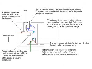

I'm gonna have to say. Good luck trying to get a set of retarders to work for a hump yard in HO. I've been working on several builds and designs to get it right but it's still not right. The main problem being is that the retarders pick the cars up off the track and derail because they are to light. If you weight them to much it will wear out the wheels and trucks making you have to change them ever couple months. I'm stumped all the way around because I've got a note book full of drawings that have failed. I did hear about one guy who did it and made it work. Not to sure though. If you can come up with something that works. Let me know.
:rolleyes: true my plan was to take some small servos or air cylinders and have them push on the INSIDE of the rail onto the flange and the actual *brake* material will be balsa or foam. I wil probably go with balsa since it dosen't create as many particles. this will be activated using DCC CTC I will try and program it so it knows what cars are in a train. ex. Train 49 pulls in and CTC knows what cars in what order it has the loco detaches and they take it up to the hump yard CTC (with the assistance of a human ;) ) will know to put more of less brake and will be able to route the cars on its own instead of having to quickly throw multiple turnouts then if there is problemt here will be a switch to stop the opperation. I think this will work if anyone sees any flaws let me know. I am thinking about using these type of cylinders......http://www2.towerhobbies.com/cgi-bin/wti0001p?&I=LXET25&P=0

Well, we have tried foam, balsa and even paint brush's and they will all work but the key to the whole thing and getting it to work right which has been the hardest part was getting the retarder to move enough without going over to much. We're talking about movement as little as a thousandth of an inch or better. I'll draw up one of my plans that worked best but the problem is still getting it to move only as much as a hair at a time. Keep in mind once the car's start downhill after hitting the retarder they won't stay at scale speed. Like, all of my car's are equipped with KATO roller bearing trucks which roll so good they can pick out even the slightest bit of uneven, unlevel track. So using such a car mounted with these trucks on a hump yard, the hump wouldn't have to be very high at all unless your car's are equipped with air brakes which I highly doubt. There's a way to do it. It's just a matter of trial and error.

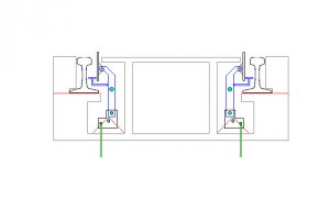

Here is a new design drawing I spent the last few days working on. I believe the idea will work for the most part with a slight modification or two but the general idea is to make the paddles move in very tiny increments because the slightest bit of pressure can make the biggest different.
Does anyone know how to animate something like this as a gif.? If so it would make this whole thing self explanatory.
