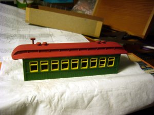

In that spirit, and in the spirit of finishing a few half-baked kits, I pulled out the Sierra Coach I started a few years back. The body has an initial coat of paint and the underbody detailing is completed and likewise has its coat of black applied.
What's left is the interior (great little Walthers add-on), the end rails, decals and weathering.

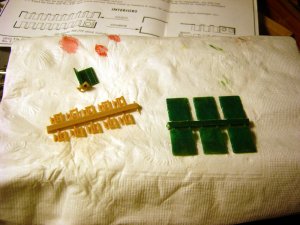

The tricky one is going to be the interior. A floor plan is provided but is not to scale. I figured I could photoshop it and scale it up to size so that's what I did, then printed a new one. Fine.
Now the hitch - the little seats provided are WAY too wide. I'm debating on whether to narrow the seats on both sides of the aisle, or chop one side in half to make a double row down one side and single seats down the other. Any thoughts?

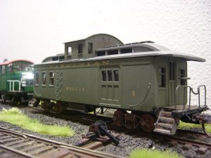

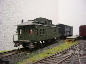

Here's a little combine I kitbashed a few years ago. The first pic shows the dockside switcher (an MDC Critter) shoving her down the rails.
Next is the other end after she has been spotted down near the section house and rail gang materials storage. Looks like she may be coupled on to a work extra in the near future. Those markers will most likely have to be moved to the other end.

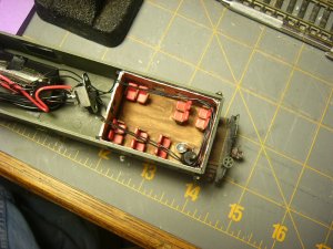

Lastly is a shot of the detailed interior. I can't remember where I found the interior details, but the walls are business cards colored with felt pens. Other items are painted with Delta acrylics. That new coal hod needs filling.
Maggie started life as an MDC Combine (50' I think), one of the older kits, not the newer RTR jobs. The cupola is scratchbuilt, as are the running boards. She has been fitted for drover's service with additional grab irons on the sides and full width coupler cut bars. Not based on a prototype, but the VGN is a stockholder/parent company for the Ocali Creek Railway so the shop crews retained the VGN lettering when the refit was done.
Just added these to show some interior detailing. I don't think I'll go that far with the Ulrich cars, but it was fun on this project. I need to add bracing to another passenger car with interior details (as well as a few passengers!) so you may get a shot or two of that one.
