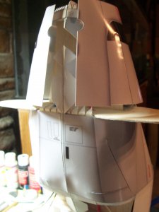

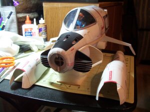

Sliding on the nose assembly to the main body making sure to route the wires properly.
It was better for me to work on the model with the body vertical. This enabled the glue to flow into the bulkheads better. It also avoided putting pressure on pieces that didn't need pressure.

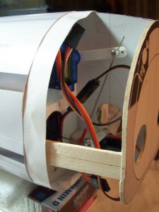

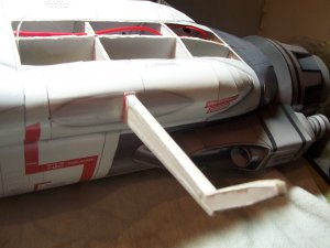

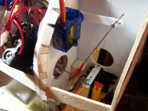

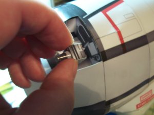

This here's the micro-servo used for the canopy operation. I made a long control arm out of thick plastic-card to give enough throw :blueface: The servo at the bottom is for the pilots animation.

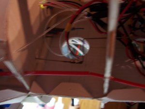

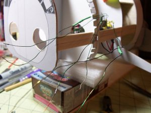

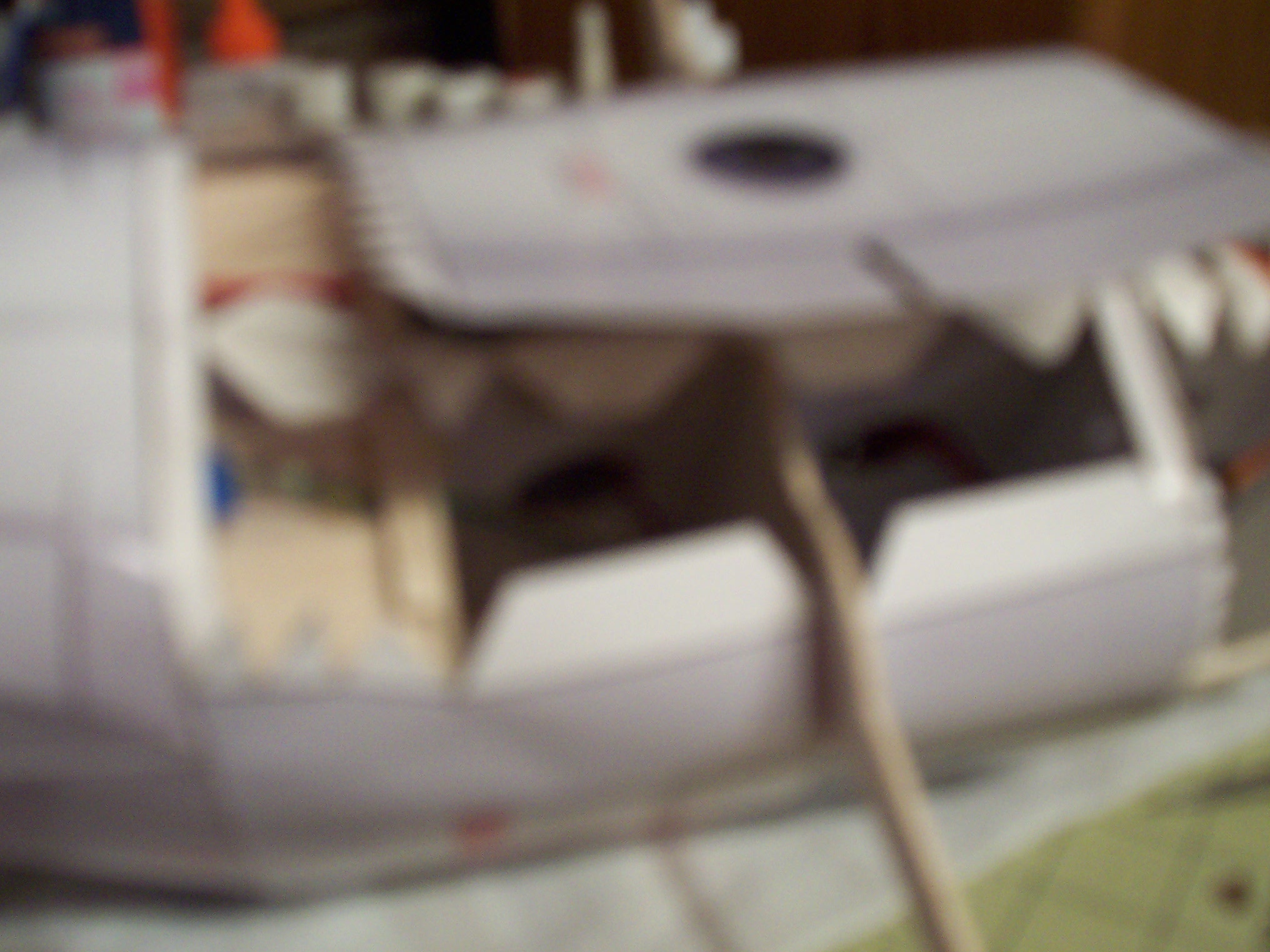

A bit blury, but more detail on the routing of the fibers and wiring.

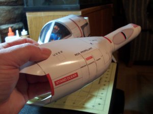

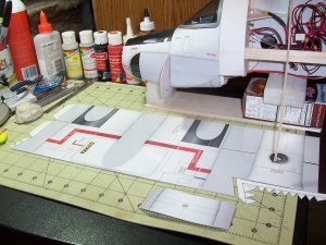

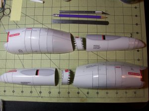

Time to start work on the rest of the body panels. My work table was getting way too small for this guy!
Getting a nice glint off the paper This all brings back happy memories! I really enjoyed working on this project!

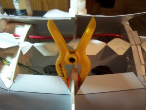

These small clamps are very useful from Harbor Freight. Here;s a wiring loom, and the bowden-cable.

More panels ready for cutting and laminating for strength.

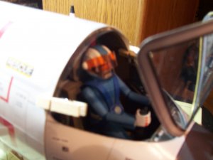

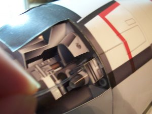

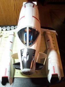

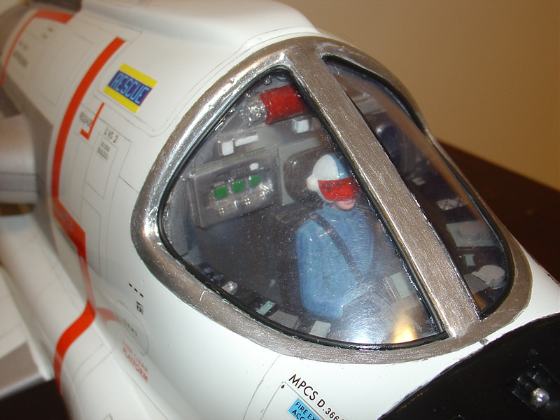

I fitted a thin transparent piece of plastic around the edge of the cockpit for the canopy to locate against when it is in the closed position. This is pretty important to make sure the canopy fits right and is snug.

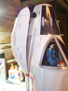

Deciding on Canopy Implementation:
I looked at all the UFO Series and movies, everything I could find to see how the canopy hinged. I couldn't find anything! We just were shown the pilot going down the slide and the next thing we see him in the Interceptor cockpit. It took quite a lot of thought, experimentation, and research to determine how it "could" work. It seems this has never been attempted before maybe?
I have a really good reference from Japan. It is all in Japanese language but there are many images of all the aspects of the UFO Series/Movie franchise at that time. Each of the pilots take their own "chute" from the internal Moon-base Launch room. The chute takes the pilot down to the lower level of the Interceptor launch bay below the moon surface. At the bottom of the chute the pilot is lowered into the seat of the Interceptor from above. This would suggest that the Interceptor Launch Bay is pressurized, so the pilots can breath.
The Interceptor's canopies are all in the open fully position, so that the pilots can be gently lowered in to the seat inside the cockpit. After the pilot is inside the Interceptor, the mechanism for lowering the pilot is retracted clear of the vehicle. Then the canopies all close and the cockpit is pressurized (it has to be because there is no sign of any breathing apparatus installed for the pilots to breath). The Interceptor Launch Bay is then depressurized, and then the sliding doors separate, and fully open allowing the Interceptors to be lifted on hydraulic platforms to the surface. They then engage thrusters and lift-off in pursuit of the UFO. When they return, the actions are reversed aside from the quick launch entry chute. Instead the pilots disembark through another path as they cannot go backwards up through the chute due to low gravity. It appears that artificial gravity exists on the Moon-Base Alpha to simulate that of earth, otherwise everyone would be bouncing around:animated: Someone told me that the Moon has 1/6 the gravity of Earth so it does have some gravity but not the same as Earth.
Okay, that is my take on the way the Interceptors launch procedure is executed. With this in mind, it would require that the canopy is fully open without obscuring the lowering of the pilot into the pilot seat. I experimented with the canopy first of all with the hinge located at the back of the canopy, and found that it was not possible to open it far enough without hitting the fairing on top of the fuselage just behind the rear of the canopy. This was due to the angle of the window (the overall shape). This would prevent the access for the pilot. Also, with the hinge at the rear, which actually would have been easier to build it would conflict with the telescope viewing system to the back of the craft (located just behind the pilot's head). With the canopy fully open with the hinge behind it actually looks kind of weird too as it sticks way high up above the top of the fuselage :Smartass:
With the hinge at the front, it allows full access for lowering in the pilot into his seat also much faster as you don't have to wait so long for the canopy to fully open as you would if it was possible with rear mounted hinges if you see what I mean? It also does not conflict with any of the other equipment, and seems to look more natural, kind of like opening the hood on an E-Type Jaguar.
So, that was my take on it as I couldn't find any reference to this in any episode, movie or otherwise :hammerhead:

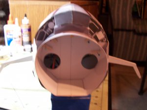

Another view of the rear body internals before they are closed forever!

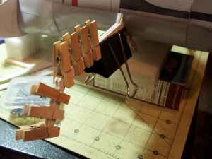

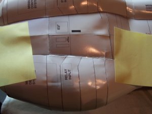

I use Post-It notes to hold parts together as it doesn't harm the paper. Also, rubber-bands, clamps, mini clothes-pins, and modelling pins. I also rest my model on a soft towel to stop the chances of damaging the paper parts by scratching them on the work surface.

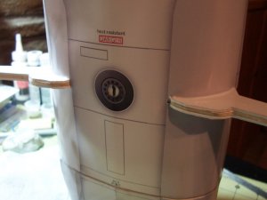

I had to plan for mounting the Missile on the front of the nose.

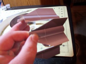

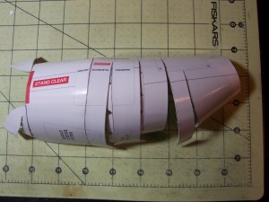

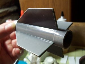

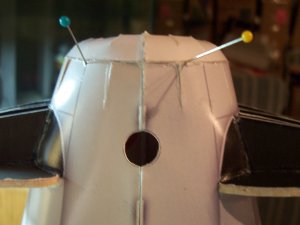

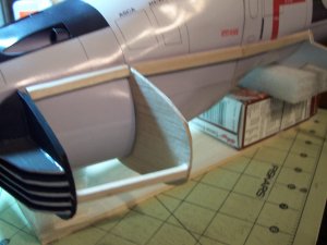

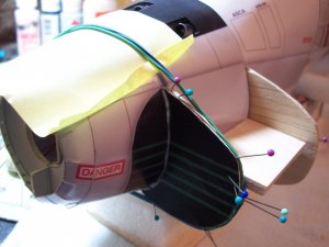

Building up the fins of the air intakes. A nice bead of white glue to add nice strength to it.
Here is the left front cowling. I did have to re-make one of these as the first attempt didn't go together right. Patience is needed on each of the joints with a strip of paper on the inside to support the parts. I cut off the majority of the tabs for all the parts as the overlap was just too noticeable, and looked bad especially due to the thicker material (laminated paper).

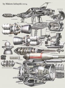

I think this is pretty awesome wouldn't you say? Fills in so many details of the mechanical's. Still no details of the canopy hinging though? :(
Another awesome picture from the same artist.... beautiful!!

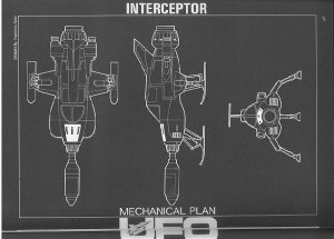

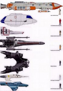

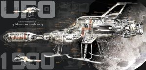

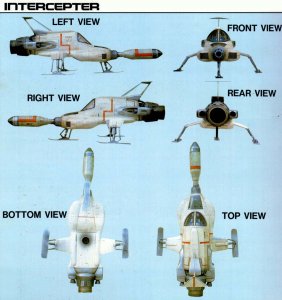

UFO Interceptor blueprints.
Unfortunately, the UFO Interceptor is not on this diagram, but hey! Its a pretty awesome reference for all the other totally cool craft including the BSG Viper. I would like to do a similar upscale build in the future.

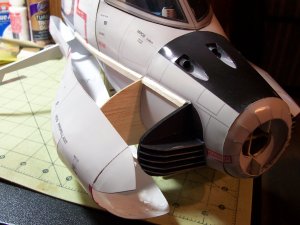

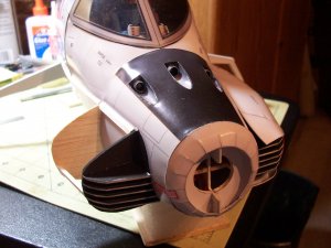

The Right side front cowling.
Ah, it's taking shape real nice!!

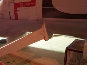

This was proof that the undercarriage was still not strong enough as you can see from the terrible cracking!! :headbange: I had to re-do this!
Yup, the other side too needs to be re-done to carry the weight.

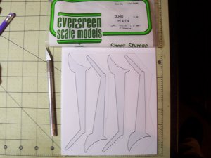

Plastic card to the rescue! 1.00mm thick. One each side of the undercarriage legs.
One thing I found out was the styrene sheet doesn't glue easy like. I found that slow drying superglue was best. The gel stuff from Gorilla worked pretty good. Also clamping was essential to avoid unwanted gaps in the layers. I also reinforced the inside of the cabin adjacent to the under-cart with epoxy resin. It was tricky to get to but hey... what can you do? :bulgeeye:

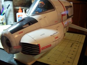

A view of the underside of the Interceptor.

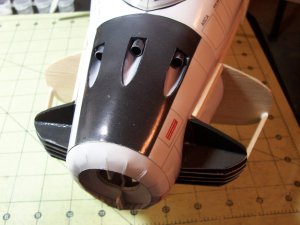

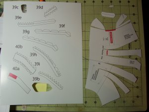

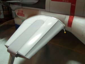

The nose was tricky to get all the flaps looking good.

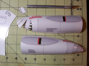

The word "EMAERGENCY", that you can see on the side of the fairing had to be fixed.
Here are the the side pieces and how they will be connected when fitted to the model.
Inside of the fairing showing the method of joining.
I made a frame to affix the fairing/cowling parts to the front. You can get away by just gluing the sides to the body with the small model, but with this size, it had to have a more solid fixing.
A close-up of the "rails".
Big pieces ready to be attached. White glue used throughout these parts.

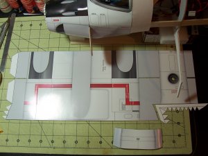

Here is the underside panel install. This was modified to enable an access flap to be created.

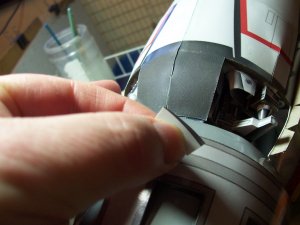

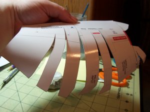

Some delicate tweaking on the edges of the paper to provide a nice curved fit. A pin holds it in place while the glue dries.

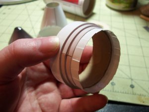

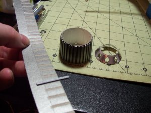

Internal fins of the Primary Engine.

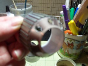

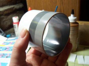

A highlighter pen was the ideal size to help shape the core.
This displays the lamination of the parts of the engine.
Looking nice! There are four layers of paper to get a nice thickness.
This is ready to install in the outer primary engine case. All edges painted silver accordingly.

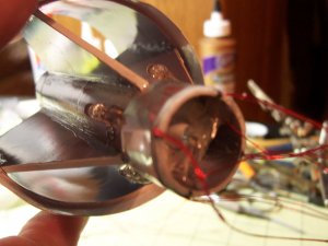

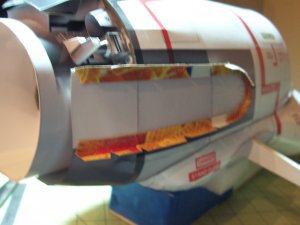

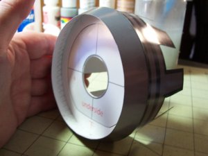

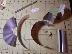

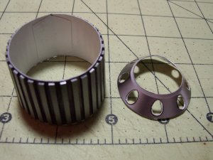

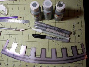

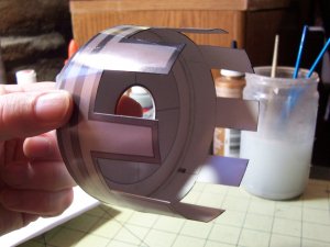

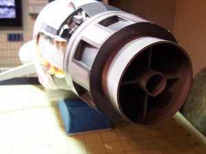

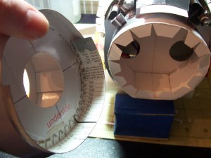

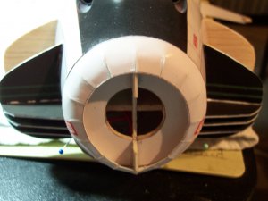

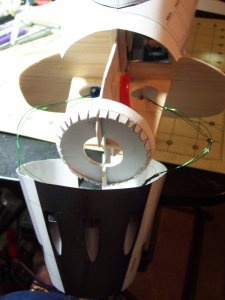

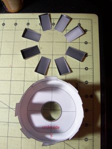

Another Primary engine piece. The surround.
Here's the engine surround part assembled. I put a nice little curve on each of the "tabs" to make it look nicer.

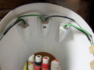

The opening for the wiring for the LEDs.
These additional shaped pieces provide a nice 3D solid shape to each of the tabs.

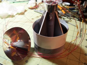

It was necessary to add pieces of 1.00 mm plastic card to stop the LED lights from showing through the paper.
Reflector(s) made from chrome cardboard. This disperses the light so it's not concentrated in small areas. The diameter of the tube I had to tweak a bit with some Tamiya 5.00mm masking tape. The inside of the engine had to be painted with matt black paint.
There are 4 white LEDs to illuminate the Primary Engine running simulation. They were glued in place using the Hot-Glue Gun. It works great for that! thumbsup:yesyes: As mentioned before, it is better to add both wires for each LED (+ and -) to avoid issues with utilizing the LEDs for different power sources, and resistances.
5 LEDs in total. One more in the center tube. This is a slide in unit that I left unglued for future modifications.

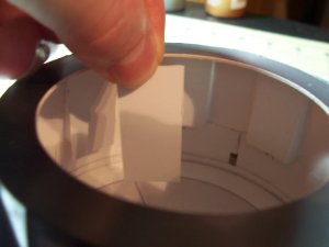

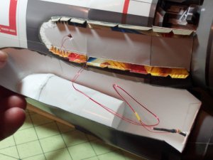

Over to the body underside. This is the access area I created. I eventually opened up the sides too for additional equipment I added. Those tabs for the spine were not required so I removed them, shown here still in place.

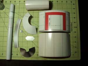

Piecing the rear parts together... very enjoyable!
The scale allows for more detail to be added if desired. Again, more openings for wires, fibers, etc. The wood and pins are in place only until the glue dries, then are removed. They help the round part follow the correct contours.
Ah, more fun stuff! The engine details!
Engine details under construction!

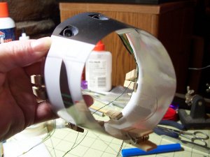

There is a fiber-optic in the engine area that is blue in color. Here it is being inserted into the drilled hole.

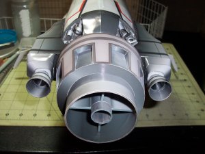

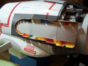

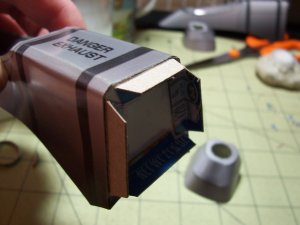

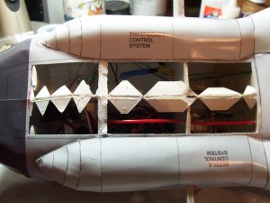

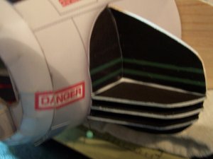

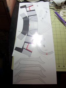

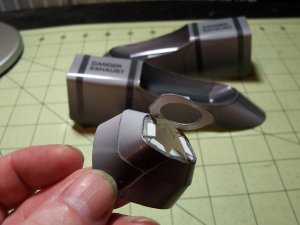

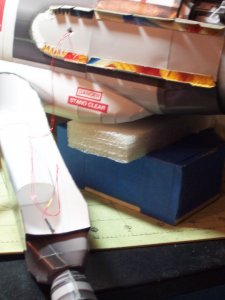

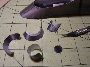

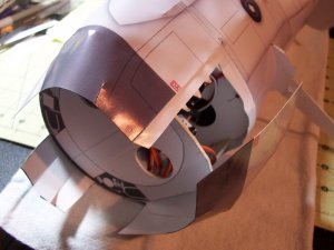

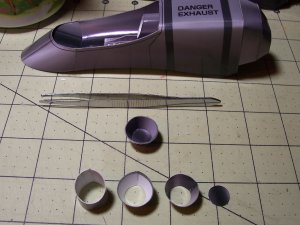

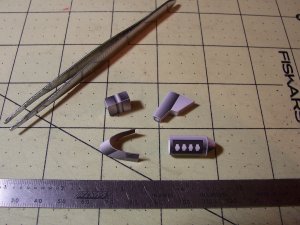

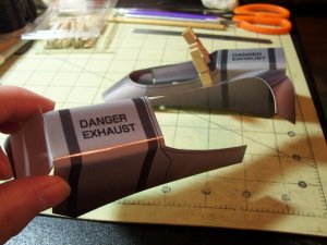

The Thruster enclosures for each of the sides. The Thrusters provide braking for the Interceptor, and horizontal movement together with the Primary Engine.
The rear of the Thrusters,
Cardboard pieces to join to the main Thruster enclosure. This avoids unsightly flaps.
I made these additional fixings for the Thrust enclosures. They enable a nice close, and accurate fit to the fuselage side. There is extra strength needed here that is not required on the small scale model.
Same for the starboard side. Thin cereal-box cardboard is sufficient.
Detail for the Thrusters. I used small panel pins to get a better look for the rivets shown here. They look okay just white when small scale, but not at the larger scale.

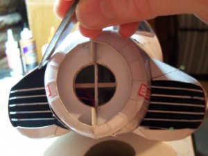

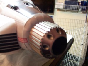

The nose looks like a drill chuck to me on the original. I added some plastic card strips to get a more 3D effect.
I sprayed the strips silver.

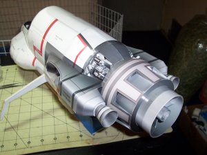

More of the engine detail being added.
The wiring for the engine

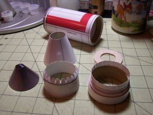

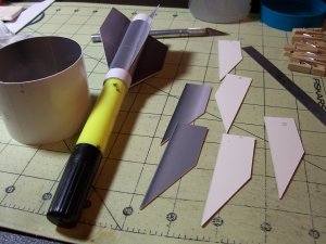

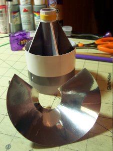

Nuclear Missile Build:
I used a large plastic medicine bottle for the central shape of the missile. The large 30 day supply bottle type ;)

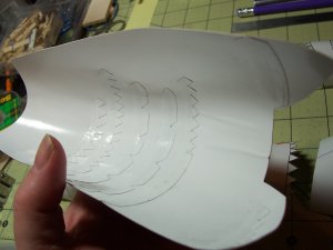

Laminating the front and back of the missile to get the stepping effect.
The node piece ready for gluing into place.

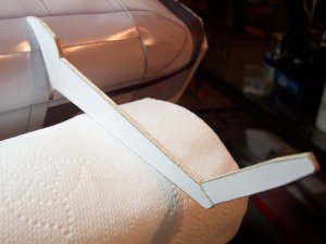

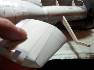

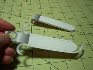

More work on the landing gear.
Pinning into place to allow the glue to dry. Afterwards the holes are filled with a small dab of glue.
Quite a lot of work getting the nose to look right but here it is finally. I added a piece of plastic irrigation tubing from the Home Depot to allow the missile to plug-in nicely.
More work on the undercarriage.
