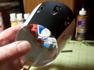

I cut additional holes for the electronics and fiber optics. There was quite a bit of pre-planning needed to ensure it could take all the needed items.

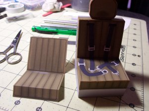

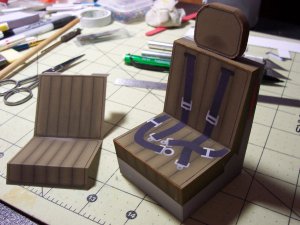

Jumping ahead a little to give a taste of things to come... here are the pilots seats. These will be modified to accept "real" harnesses.
This was one of my favorite builds. The seats are kinda cool... even a slight wear mark because of the pilots head!

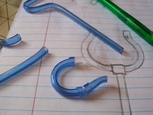

The joystick needed to be heftier! I made it from some crazy straws.
The finished joystick ready for installation.

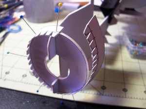

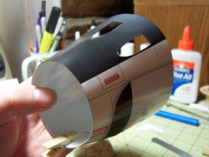

All pinned-up while the glue dries. I laminated the pieces depending on the thickness/strength needed. Usually about two or three layers worked good.
Some things needed to be changed because there were batter ways of doing things for the larger scale. I used super-glue to hold instantly, follwed with white PVS glue to add some rigidity. If more strength was needed, epoxy glue was used. Spray on glue to bond the lamination's.

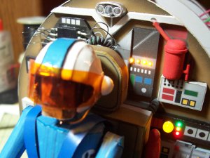

Jumping ahead a bit again in the following few pics. Here's that canister looking thing that hangs in the cockpit next to the pilot's head. I made it out of balsa wood and plastic rods.

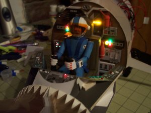

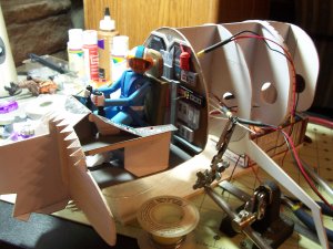

I love the picture imports on this site! They are nice and big and clear! Thank you! I laminated the controls on the dashboard to give them a 3D affect. I also used fiber-optics to illuminate the small lights on the bulkhead, and the Interceptor's dashboard. (The pilots build will be at the end).

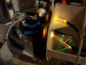

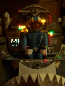

You might notice the other lights on the dashboard are tiny jewels that are super-glued into place. The catch any light that is going on around really well. You can see the pilot has legs, and shiny boots :) He can be removed if desired.

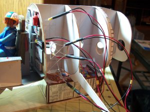

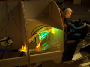

Lots of LEDs and fiber-optics to run through the body. The fiber optics have to be taken care of because they can break if too tight a curve is attempted.
I used thinner wire eventually as the thicker stuff wastes space.

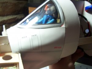

Canopy construction. I used a piece of brass tubing curved to match the top of the canopy and was eventually super-glued in place.

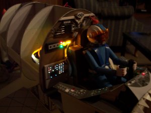

Lights on for testing!

Ah, good view of some of the fiber-optics in action here!

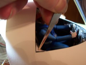

Bit more of a close-up of the cockpit detail in action, The rear view telescope with the three lenses.

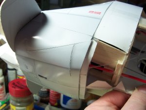

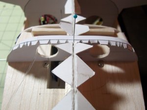

Starting to build up the sides of the body.

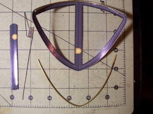

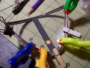

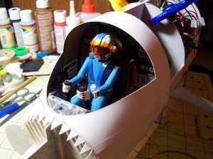

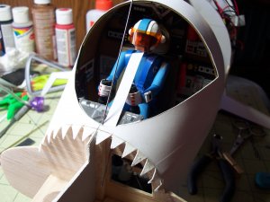

The central wire support for the canopy. Also the brass tube in place. This was the most intricate and difficult part.
A custom made hinge for the job.
Tricky, tricky! Lots of clamps to hold it all together while the glue dries.

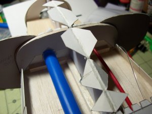

The canopy is operated via a bowden-cable setup with a couple of bell-cranks. The blue tube carries wiring from front to rear.

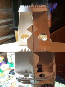

Underside of body - nose area.
Time to test the canopy for fitment and adjust accordingly. The brass tube allows for tweaking.

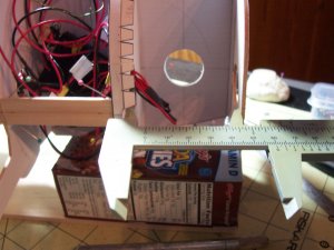

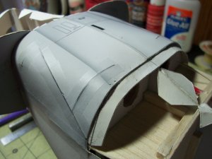

Extra support needed here to prevent squash when you handle the model.

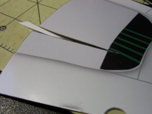

Slits in the parts to allow butt-jointing the edges together with no overlapping. Paper glued below to avoid unsightly joints. Any defects are easily apparent due to the shiny finish of the panels.

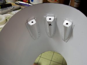

Cutouts for the high-velocity machine guns at the front.

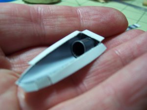

These are the actual machine guns. These are illuminated with orange lights to simulate firing.

Holes all ready for LEDs to be inserted, and wired-up:yesyes:
