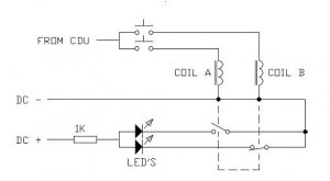

Hi Woodie,
This would be my personal preference. If you want to use a separate
relay, you would wire the two turnout coils in parallel with the two relay
coils. You can use an Atlas Snap Relay. Using the DC return as common
for the LED's saves one wire to the turnout.
My take on this is that using the auxiliary switch on the point motor
tells you the true condition of the turnout. The other control panel
methods must infer the turnout position from which switch was last
thrown or which button was last pushed.
