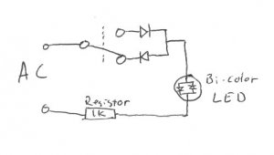

Rather than using the PL-13, you could wire in an inexpensive (if there is such a thing) latching DPDT relay with the coils on the switch motor, and it would switch power to the LED's. The latching types will stay in one position until a shot of current hits the opposite coil, and 'latches' it in the other position. This relay could be placed wherever it was convenient. As well one side of the PL-13 could be used for this, but like you said, then you would be running miles of wire.
For LED's you could use some bi-color (red/green) ones on your panel to indicate which way the turnout is thrown (green for main, red for diverging). They could run off of AC power, and use one side of a DPDT relay and a pair of diodes to control the polarity flowing through the LED (see crude drawing below).
I'll send you a PM concerning relays and LED's.
Hopefully you, or someone else can use these ideas...
Pete
