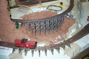

I couple months ago my club decided to change part of the mountain area a bit and that involved building a new, shorter trestle. I was the one nominated to build it. I did alot of research into the real thing so it would look as convincing as possible. Last year RMC did a story on trestle building which was invaluable as well I attended a clinic at a MR meet last spring that gave me alot of info as well. While I was at it I needed one trestle bent for my own layout so I built it while I built the others. I took a few pictures as I built so here they are:
Here's a completed trestle bent. I drew the plans for it on the peice of paper and pinned the plan onto a piece of blue insulation foam along with a sheet of wax paper on top of it. As I added wood parts to the bent I pined them in place on the plan so I would end up with bents with equal lengths. I needed 6 bents to buld the 70 foot trestle. This as actually the bent that I built for my layout. Below it is the footing that I built at the same time.
This isn't a very good picture but it does show how the stingers and crossbracing go. There is alot more structure in a real trestle than I see modelers add in their own. I page through older MR magazines and see most of the trestles leave out the crassbracing which in real life would make the trestle fold over like a deck of cards.
This is the completed trestle on the club layout. It was also built on a curve which made assembly difficult. I had to pin the top stingers together and laminate them out of two strips so they would hold the cuvature. Then I glued the bents on, assembling the trestle upside down. You can't see in this picture but I 'faked' hardware buy using a fine tipped felt pen.
Finally be perpared to buy a large amount of stripwood when bulding these. This 70 foot trestle (scale feet) ate up almnost 40 (real feet) of lumber.

The frame trestles were set onto footings, either wood or concrete like what I made, Pile trestles were set on piles driven into the ground. Here's a better picture of my one bent about to be set up into position:
You can see the cribwork footings at the base. Since this picture was taken I added the stream that the cribwork rests in and the top stringers that secure the bent to the wooden abutment. I hope this makes it a little clearer:
This is the underside of a real wood trestle. You can see the bents on the bottom are either resting on their wooden footings (left side) or their concrete footings(right side). These are frame trestles. The ground it almost all rock through this area so driving piles is impractical, if not impossible.
